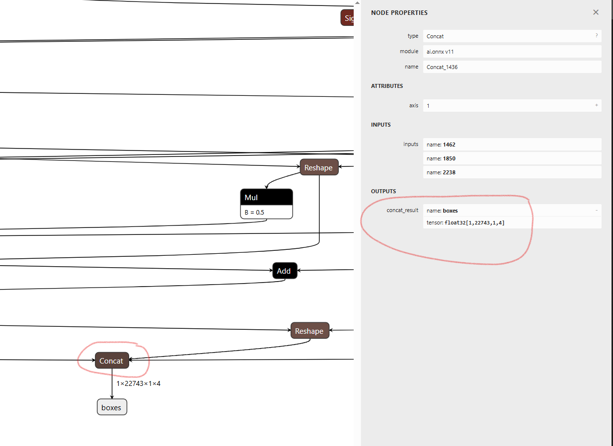

How can I know for sure that I choose the right end nodes in YoloV4 ?
Might be something like this? :
@omria Hi Omri can you provide some info on where can I find the data on NMS layer ?
