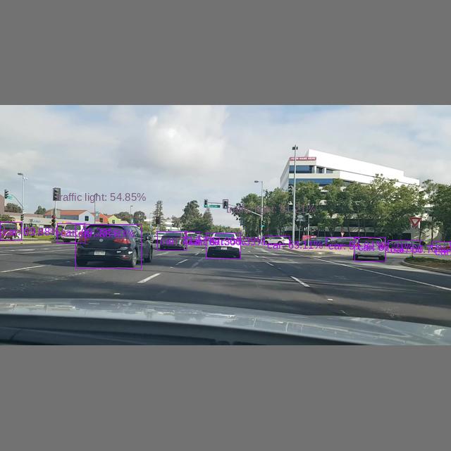

I was playing with async_detection_inference example and I’ve noticed that NMS might not work correctly:
As you can see, the bounding boxes around given object are not suppressed. I am using HAILO8 and model yolov6n.hef taken from model zoo.
Is there anything else I need to turn on for NMS to kick in?

Thanks for reporting this issue with the duplicate detections. There are two potential scenarios we need to investigate:
We might be getting two legitimate detections that are being placed very close to each other
There could be a bug where we’re accidentally drawing the same detection twice
Let me look into this more deeply and I’ll get back to you with our findings and a solution.

Hi @omria
many thanks for checking that out. I reported badly the Hailo type that I have. It is HAILO8L (sorry, I could not edit my post).
I’ve also experienced the same issue with different model: yolov8n.hef
If you need me to do any more test or I can help in any other way, please late me know.

Hi @Chuck_Rhoades
Is this happening on a video stream or even on a single image?
Hi @shashi this is happening on a single image.

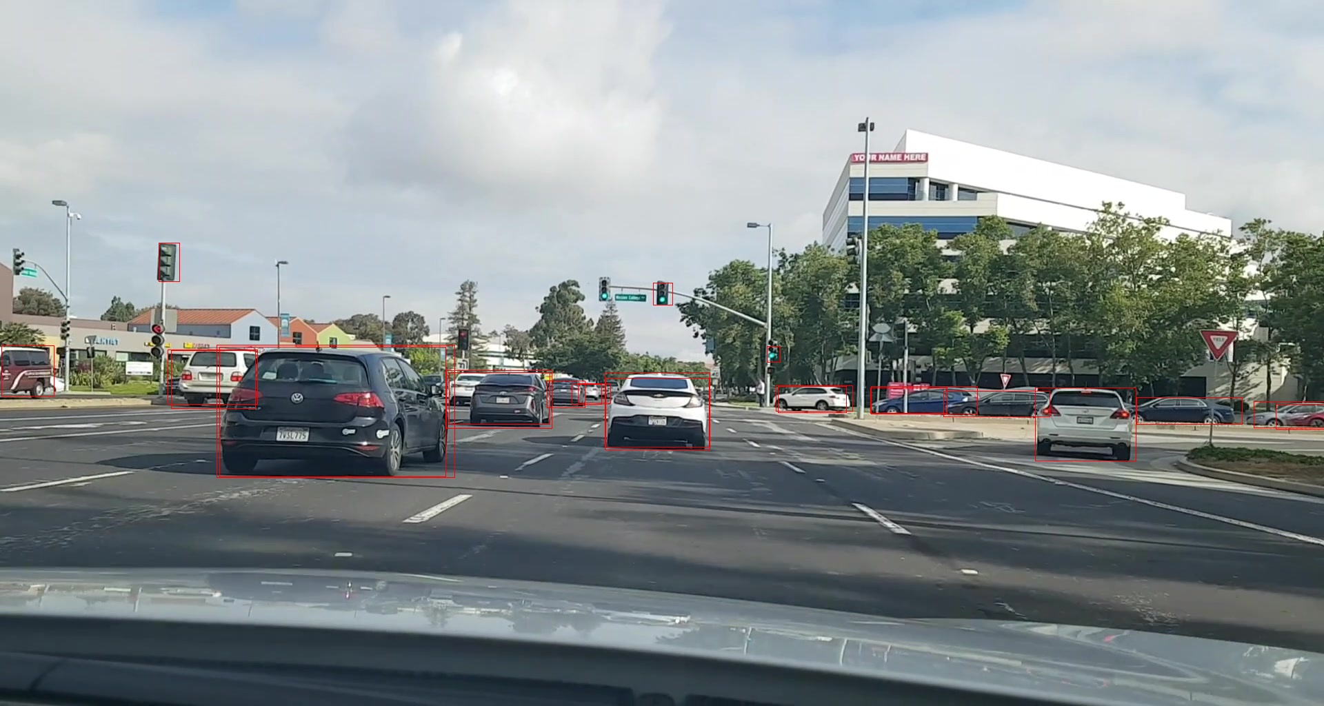

I’ve modified C++ async example to do the inference only on one frame. Here is the result:
And then, I took the same frame and passed it to Python object_detection example, and here is the result:
So I think the problem lies in C++ code not in the model itself. I’ve used the same model.

Hi @Chuck_Rhoades
We tried multiple models from the model zoo using our PySDK and did not notice it. Perhaps you can try with PySDK once: User Guide 3: Simplifying Object Detection on a Hailo Device Using DeGirum PySDK . Alternatively, if you provide original image and the model name, I can try it on my side.
dear @shashi it is because you’ve tried it via Python, and as I wrote in my subsequent post, in Python it works for me too. It is probably something in the code for C++ (Hailo’s “common”?) that is messing things up.
