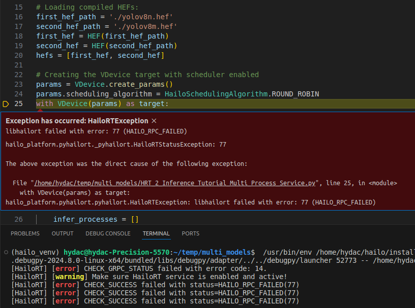

I am following the tutorial and it gives following error:
Could you please explain the error.
