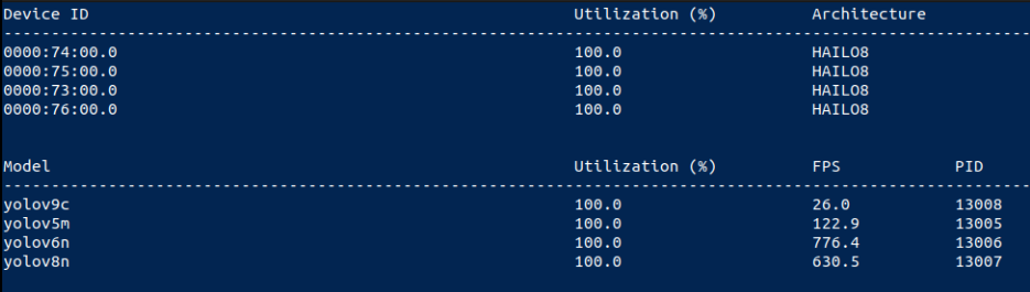

You can have a look at the Hailo Monitor to find out how many devices are active.
Before you run your application you need to enable the monitor by running:
export HAILO_MONITOR=1
In a separate terminal call the HailoRT monitor.
hailortcli monitor
The output will look something like this.
The multistream detection only uses one device. There is a century example in Tappas that uses multiple Hailo-8.

we also monitored with your guide(hailo_minitor)…
  1. When we using H4 cards(HAilo-8 x 4), hailo_miniot shows 4 device working.
    this means 4pcs device works not 1pcs under multistream pipeline.

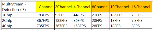

our test result for your understanding. (Intel 12th 13 CPU)
from 8Channel in sheet(actually, we think it is from 5CH), all FPS value under Hailo-8 x 1 or x2 or x4 are same…
we can assume that this example works on 1 chip.
but as i said, the FPS from 1CH to 4CH are very dramatic result per number of NPU.
If example works with only 1 chip, all FPS should be same even if we set the NPU as multi.
I hope this is helpful for your understanding about my question.
thanks
So, the multistream_detection in TAPPAS supports only one device but can be easily modified to support multiple devices by adding the device_count parameter to the hailonet element.
I guess that is what you did. Right?
I think I see why. Your results are influenced by other factors e.g. the video decoding capability and compute power of the main CPU and the PCIe. That is why the numbers with more channel degrade. Here is how you can test this further.
You can test the hef file without the app using the HailoRT CLI. Run
hailortcli run resources/yolov5m_wo_spp_60p.hef --device-count 1
hailortcli run resources/yolov5m_wo_spp_60p.hef --device-count 2
hailortcli run resources/yolov5m_wo_spp_60p.hef --device-count 4
This will give you the maximum FPS for that network on your system. e.g. 217 FPS, 434 FPS and 865 FPS. If your numbers are lower then you know that you loose some performance due to the PCIe bandwidth available.
The rest of the performance is lost due to the app (pre- and post-processing) and video decoding capability of you host CPU. With a higher end CPU e.g. i5/i7/i9 you would get increasingly higher numbers. I get very similar numbers for 1 video channel like you but >2x for 16 video channel and 4x Hailo-8.
