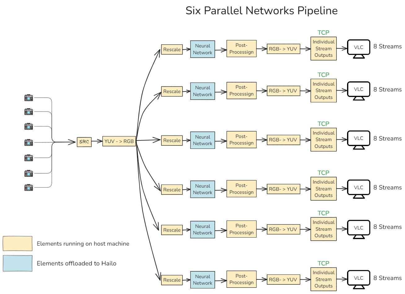

My goal was to create multi stream and multi network. since 1 hailo device can handle 8 streams. we have PCIE with 6 hailo 8.
Any can help me with this everytime i run i end with error from gstreamer.
i follow also multistream detection rtsp guide from tappas. if i combine all the streams in one there will be bottleneck in the middle so simplifying the network might be the case.
