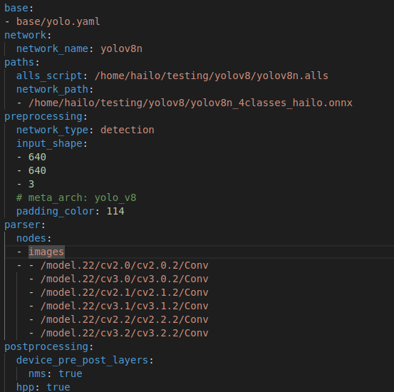

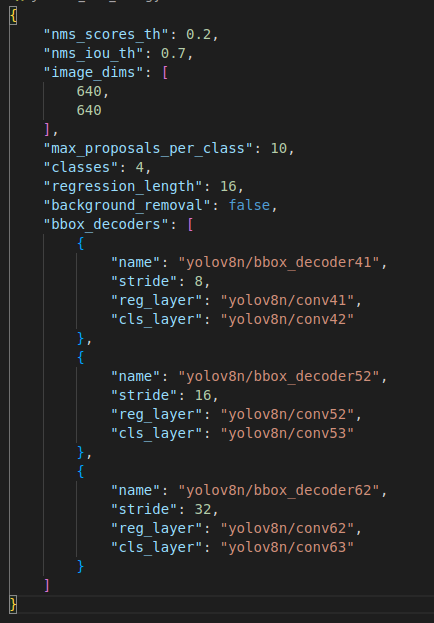

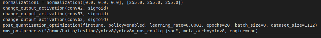

Yaml file, yolov8n alls file and nms config in attachments:
Where should I mention devie Hailo-8 in onnx to hef compilation files?
