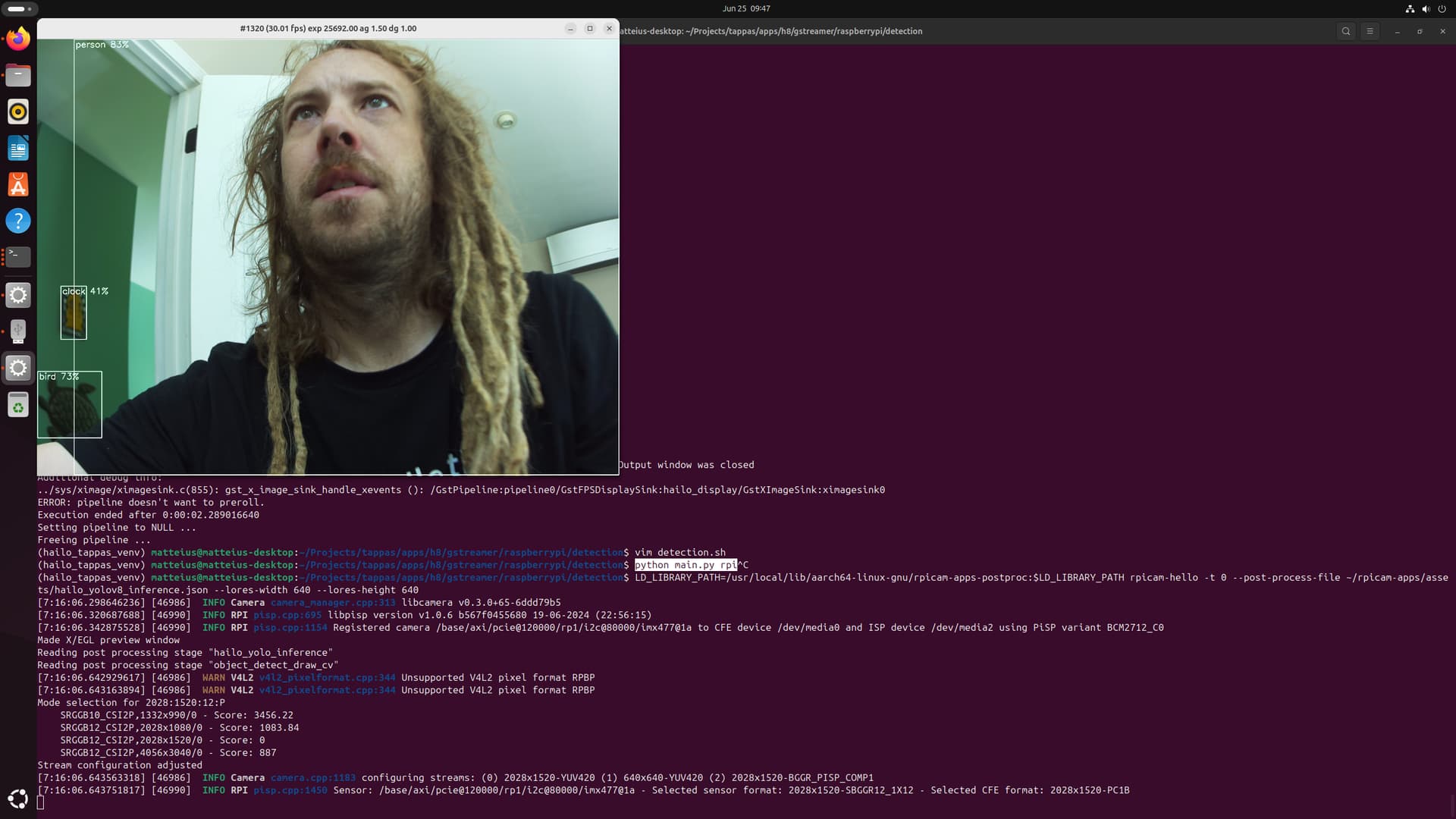

@giladn Thanks, I just tried this – everything compiled, I moved some shared library objects to the right space to be loaded, but I still get a warning/error No post processing stage found for “object_detect_draw_cv”.
It seems everything is working except its ability to write back to the preview window the result.
matteius@matteius-desktop:/opt/hailo/tappas/lib$ rpicam-hello -t 0 --post-process-file ~/rpicam-apps/assets/hailo_yolov5_personface.json --lores-width 640 --lores-height 640

I tried on Raspberry OS on a different device and it worked pretty much out of the box, but its not clear yet how to tune things once I get that far. Seems the rpi examples all feed in a fairly low res 640x640 image, and I was expecting to see more class of objects detected than what it was really doing. Though it did detect me and a TV near by.
I got yolov8 inference (and some other ones) working on Ubuntu finally. I had to remove and rebuild my rpicam buildir after rebuilding tappas, somehow I got it to work. Where we can we see what all its trained to recognize? It certainly detects objects, but there are plenty of objects it appears to not know about,.

[HailoRT] [error] CHECK_SUCCESS failed with status=HAILO_INVALID_HEF(26)
CHECK_EXPECTED_AS_STATUS failed with status=26
It seems even specifying python main.py rpi doesn’t download compatible models.

Hi @matt Nice to finally see you :wink:
The error you get is because you are using a H8 HEF on a H8L device.
