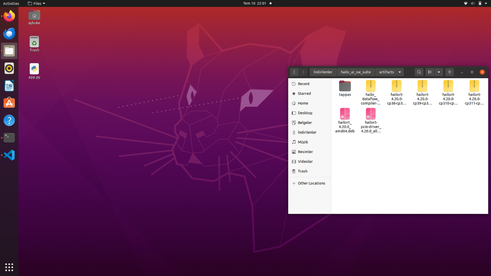

:white_check_mark: Verified the existence of all Hailo software suite components (as shown in attached screenshots)
:white_check_mark: Attempted imports in both fps_test.py and detection.py (still failing with the same error)
However, we still encounter the same error:
bash
KopyalaDüzenle
ModuleNotFoundError: No module named 'hailort'
We have attached all relevant screenshots showing:
  • The project and environment structure
  • The correct .whl files present
  • That we are running the Python script inside the activated virtual environment
  • The hailo-ai-sw-suite structure and artifact files
