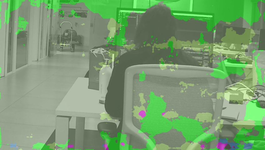

I have a compiled hef B0 segformer. I manage to build the application arround it. However, the results of the inference looks very bad. I am attaching here an image showing the inference results. How can I improve the results? From where to start?

The image you uploaded indicates that the segmentation result is noisy, with inaccurate and fragmented predictions overlaid on the original image. To improve the inference results of SegFormer B0, you can start by checking the following:

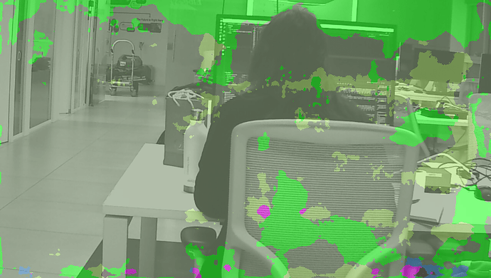

Thanks a lot Oscar. This is a b0 segformer model that i have trained on a single channel images. then i compiled it to hef model. hence there is no need to resize to 512512 but rather to 480848. I did find problems in the preprocessing step but it didnt improve the results and the green artifact coming out from the model as in the image i attached is still there. I suspect its from the model. how do i know that the hef model has been generated adequately?
