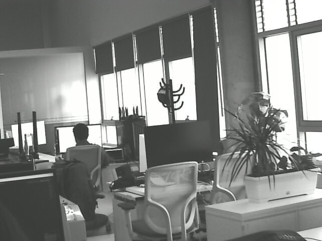

- the original image

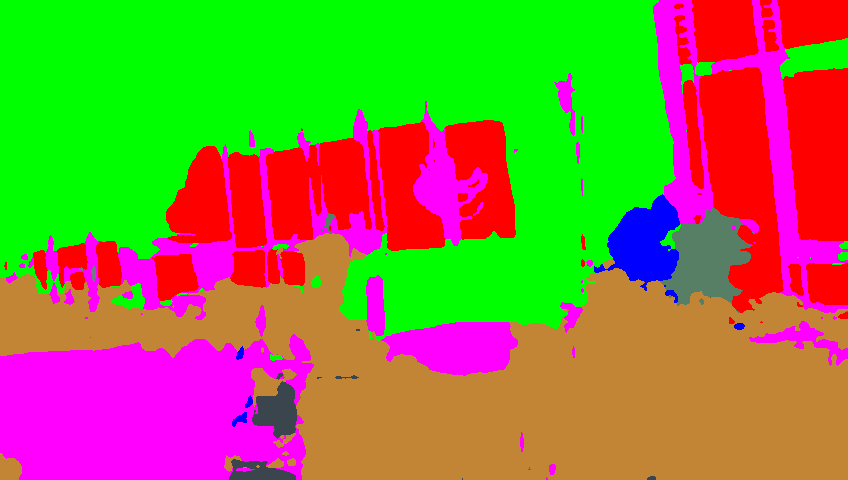

- the segmentation as it accepted from the onnx model

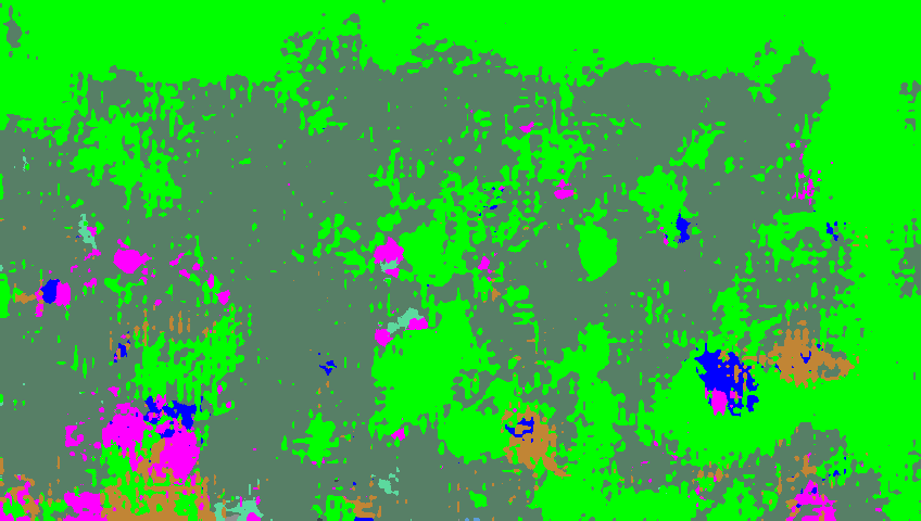

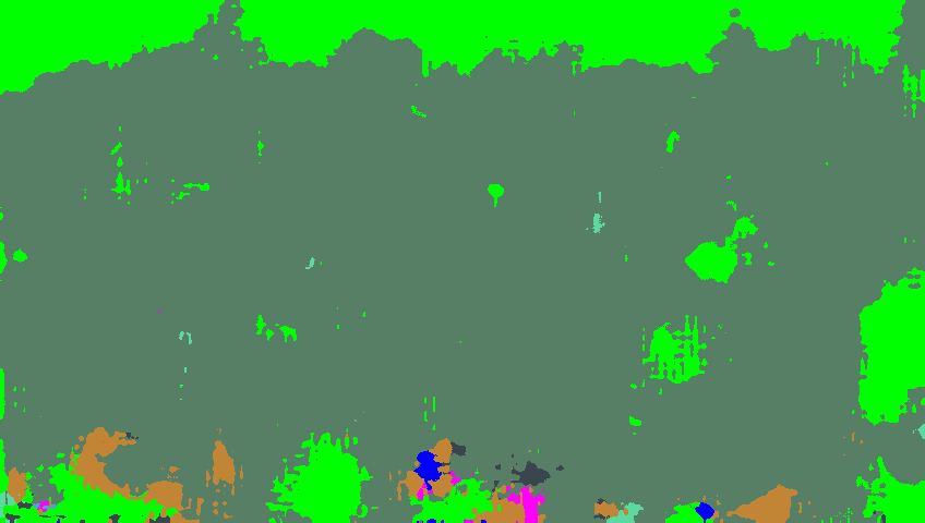

- the segmentation as it accepted from the compiled hef model with compiler version 29.
- the segmentation as it accepted from the compiled hef model with compiler version 30.
