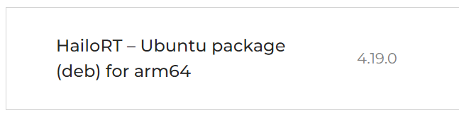

Yes correct, this is the libhailort on the sw download page:

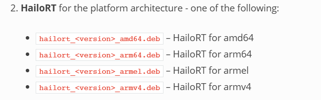

Hey @porbenten2545 ,
To help you better understand the different components and address the ModuleNotFoundError: No module named 'hailort' issue, let’s break things down:
  1. hailo-rpi-examples: This repository provides a GStreamer infrastructure for capturing and processing input from video files or cameras. It uses Python to extend the functionality. If you want to use your own HEF (Hailo Executable Format) file and customize the pipeline, you’ll need to modify the callback function. You can find more information and the code in the following repository: GitHub - hailo-ai/hailo-rpi5-examples
  2. Hailo Code Applications Example: This repository contains generic Python and C++ examples demonstrating how to run Hailo inference on various platforms. It serves as a reference for integrating Hailo into your own applications. You can explore the examples in this repository: GitHub - hailo-ai/Hailo-Application-Code-Examples
Now, regarding the error you encountered:
This error indicates that the hailort module is not installed, rather than an issue with pyhailort. The hailort module is part of the Hailo Runtime Library, which is required for running Hailo inference.
if you keep seeing this no hailort error , please run the installation in here
