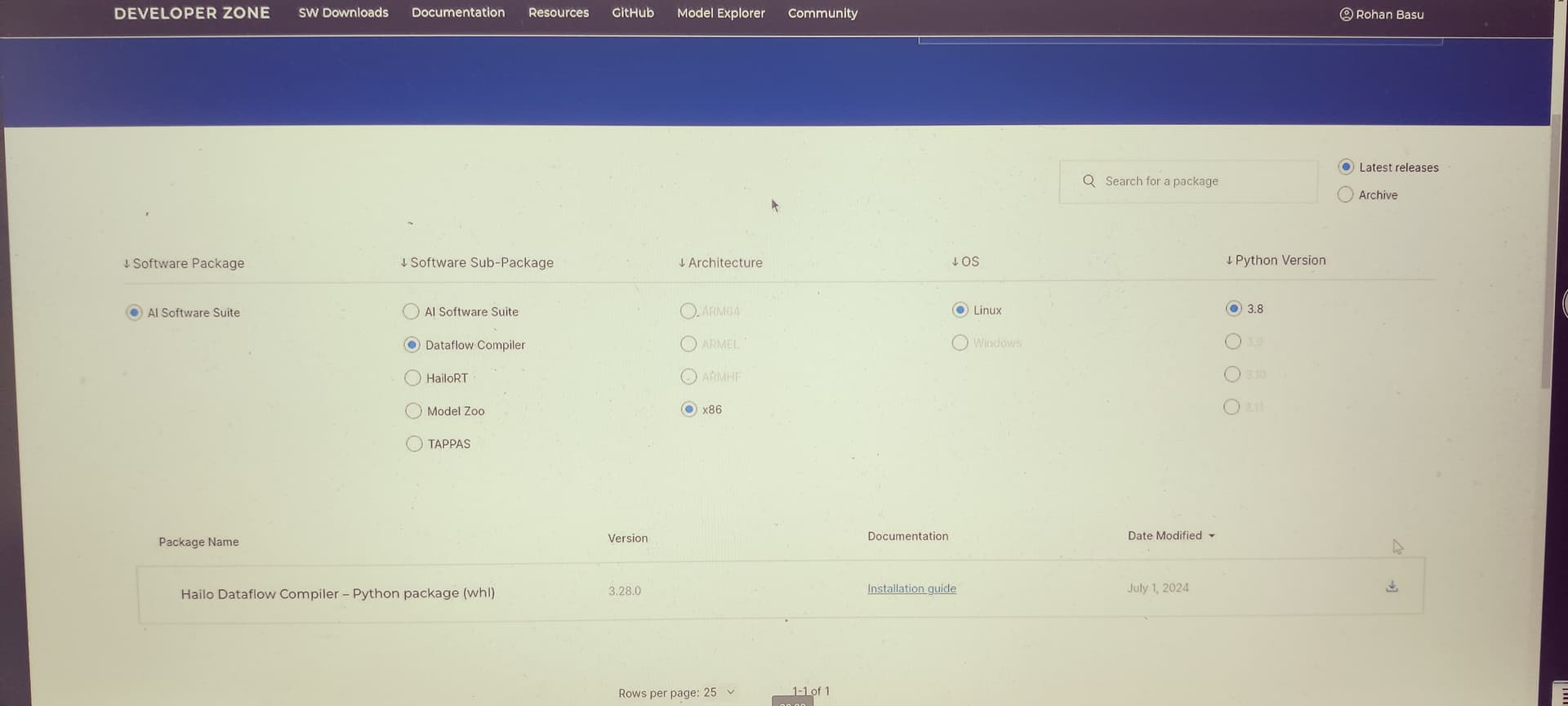

But its only for x86 the arm option is blocked.How will it run on rpi
Another problem is it is only available for Python 3.8, which is almost end of life. Ubuntu 24.04 currently ships with the recommended Python 3.12. Getting this compiler to work is going to be difficult.
Hey @jpm,
The recommendation is to install the DFC inside a virtual environment. This is because we want to maintain support for previous versions of the software, and we will be adding support for newer versions of Python in the future.

Hello @basuroyrohan,
The DFC is only available on x86 machines because it is a compiler used to create models, but it does not actually run the models. On Raspberry Pi devices, we only run the pre-compiled models and use them, we do not use the DFC compiler itself on the RPi.
