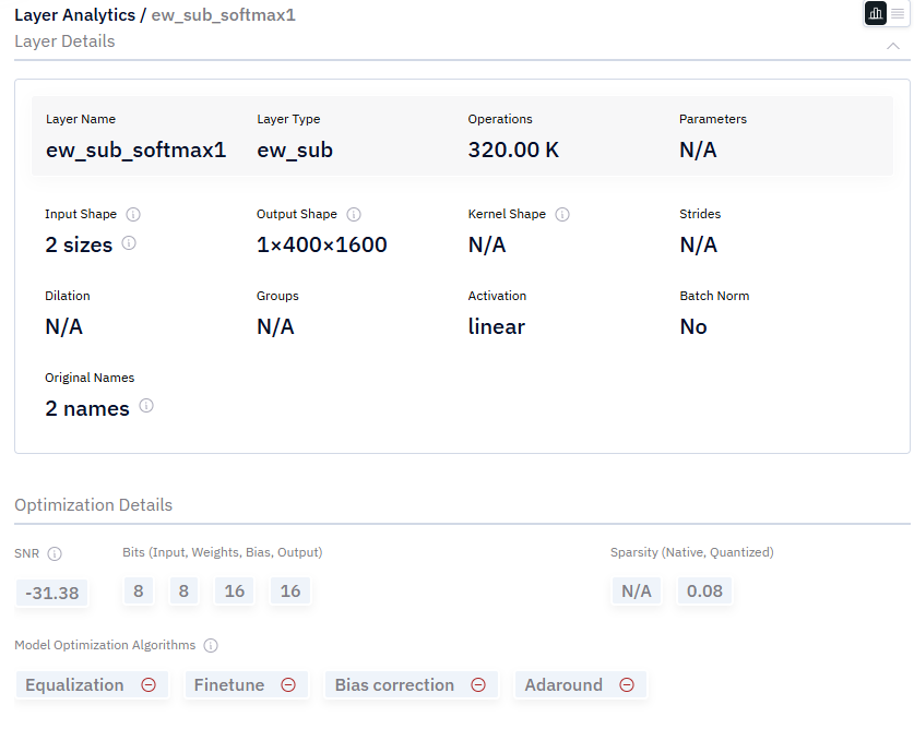

I’m currently optimizing a model on the Hailo platform and noticed that some layers are showing poor Signal-to-Noise Ratio (SNR) during evaluation. I’m looking for guidance or best practices on how to improve SNR in these layers.
Here are the layers with the worst SNR values:
ew_sub_softmax1: -31.38

I’m particularly concerned about the very low or negative SNR in layers like ew_sub_softmax1, reduce_sum_softmax1, conv53, and conv80.
