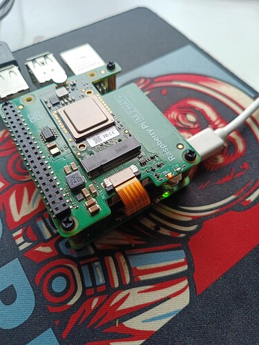

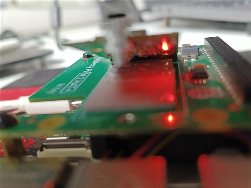

  1. Hardware Check - The cable is attached properly. The hat has an orange led lit up and running. The yellow led that used to blink earlier has completely stopped blinking.
  2. PCIe Configuration - It is already switched to PCIe Gen 3
  3. System Logs - Absolutely nothing comes up when I ran these 3 commands.

The cable between the HAT and Pi appears to be correctly oriented, but please check that the two ends are pushed fully home and the two brown locking tabs are pushed in.”
Rockets are loud.
Thanks for the logs!
Your Hailo8 isn’t working because there’s a hardware connection issue, not a software problem. The error message saying the driver isn’t installed is misleading - the real issue is that your Raspberry Pi can’t even detect the Hailo device because they’re not properly connected.
When you look at your system logs, one of your Pi’s connection ports shows “link down” - that’s where your Hailo device should be connecting, but there’s no electrical connection happening.
Here’s what to try: Just unplug that ribbon cable and plug it back in firmly on both ends. Or better yet, if you have a spare cable lying around, try swapping it out completely.
One important thing - make sure when you’re plugging it back in that the black side of the cable connects to the black side on both ends. Getting that backwards is a common mistake that’ll cause exactly this kind of problem.
Hey, I am pretty sure that the cable is seated perfectly well. One thing I don’t understand is that if the cable is the issue, why would the PWR light as well as the light under the 8L chip glow up?
Hi @Virag_Shah can you try:
dmesg | grep -i pcie
Already did. The log message sent above is for the same
Hey,
I replaced the ai kit hat with a different one that supports hailo8l. Plugged in the cables preoperly, did sudo apt update && sudo apt full-upgrade, did sudo apt install hailo-all Ran Hailortcli fw-control identify and I am still getting ERROR cant find HailoRT driver class. And on running dmesg | grep -i pcie i got -

Kindly tell me what to do next?
Anything ??? @omria @Klaus_Koschinsky
You should be able to see the Hailo device using the lspci command without any update/upgrade or software installation. If that is not working you have a hardware issue.
I also recommend installing the GPIO header connector. In the images above it looks like it is not installed.
Well if the hardware is damaged -
1. it shouldnt be able to enumerate an ssd mounted on the seeedstudio dual m2 hat
  1. the Hailo8l chip is also being enumerated on the jetson orin nano.
  2. It is also showing link up between the new seeedstudio dual m2 hat and the pi so clearly that is also working
  3. I switched the SD card and the Hailo chip from one pi to another one… it isnt showing up there either.
What hardware do you think I should try swapping ?
I did not say damaged. But you need to solve the hardware issue first. Installing any HailoRT PCIe driver and/or HailoRT will not help.
That is a good test. So, the Hailo device is OK.
I tested a dual M.2 HAT (a different model) and did not have any success with it. We and some of our partners have PCIe cards with multiple Hailo devices and PCIe switches. However the PCIe switches on these cards are PCIe gen 3 + and usually large chips with heatsink and fans. Maybe the HATs use some older cheaper PCIe gen 2 switches that are not suitable.
Did you use standard 64-bit Raspberry Pi OS?
Did you install the 40-pin GPIO header?
As for the M.2 Hat i tested with this - PCIe2.0 to dual M.2 hat for Raspberry Pi 5, Support NVMe SSD, Support Hailo8/8L
And i use the standard 64-bit Pi os and I installed the 4- pin gpio header for the original Hailo8l AI kit, for the seeedstudio one, it mounts on the back of the pi in such a way that five pogo pins connect to the required gpio pins on the pi5
