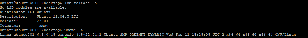

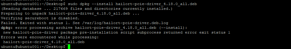

This is my ubuntu spec im using Right now im facing this error and im not to sure what causing this error
Error exit status 1

Regarding your issue, it appears that the kernel version you’re currently using is not supported by our software. To resolve this, please follow these steps:
  1. Upgrade your system to kernel version 6.5, which is compatible with our software.
  2. After the kernel upgrade, attempt to reinstall our software.
If you encounter any difficulties during this process or need further assistance, please don’t hesitate to reach out. We’re here to help ensure a smooth setup experience.
