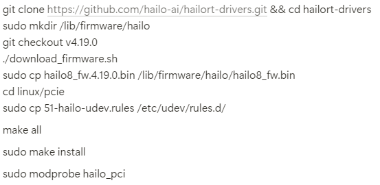

I installed Hailo in the following way.
and, it was installed normally.

+ADD
Hailortcli scan works well.
Hailo driver was installed well without error.
