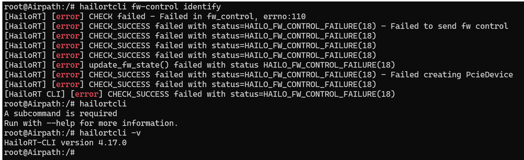

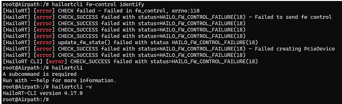

problem always happens.
we tried several pcie driver and changed several hardwares.
but still same error when testing hailortcli fw-control.

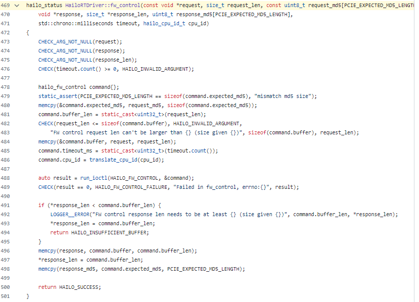

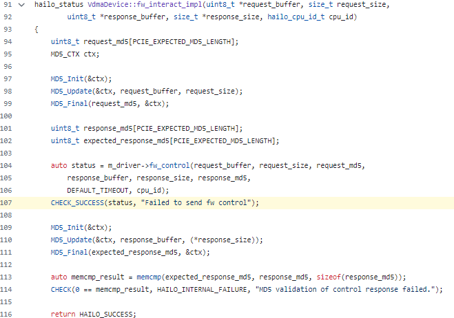

Looking at the driver source code, this is the function that originates the error:
and this is the inner implementation:

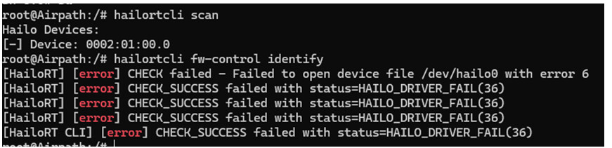

I am currently facing issues with the Hailo driver on my Raspberry Pi 5, specifically while trying to use the Hailo-8 AI processor connected via PCIe. My goal is to run my own custom model (not pretrained) on this setup. After installing the Hailo driver and attempting to run the hailortcli scan command, I consistently receive the following error messages: [HailoRT] [error] CHECK failed - Failed open /sys/class/hailo_chardev/hailo0/accelerator_type and [HailoRT] [error] CHECK_SUCCESS failed with status=HAILO_DRIVER_FAIL(36). My kernel version is 6.6.31+rpt-rpi-2712, which is compatible with the driver according to the documentation.
I would like to know if I need to install the full hailo-all package or if I should just be using the .deb file. I have tried both methods, but unfortunately, I am still encountering the same error. Can someone help me with it?
