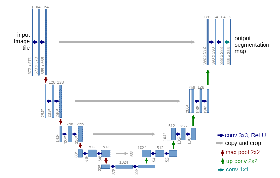

The original U-Net is shown here, and the U-Net structure I am trying to convert is the same as the original U-Net
I’m just changing some convolution algorithms, maybe pruning, reducing the number of layers, and of course changing the size of the input and middle layers,

OK, I suggest to simply use the DataFlow-Compiler (DFC) for compiling that network for running on Hailo.
You can follow the tutorial that we have, either in the DFC user guide (4.2. Parsing Tutorial, 4.3. Model Optimization Tutorial, 4.4. Compilation Tutorial), or after you have installed the DFC use the hailo tutorial command to launch the Jupyter notebooks.
