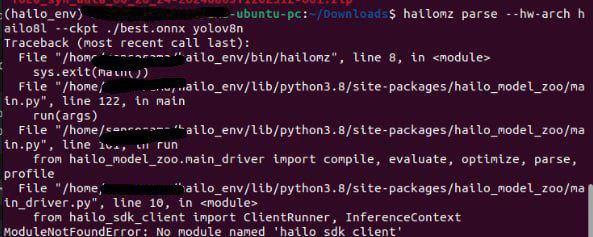

Thank you for your help. I managed to install DFC and hailo model zoo. But when I start to work with my model in onxx format, namely, I write the command hailomz parser … , I get the error no module name ‘hailo_sdk_client’.
Hey @vlad.purhin,
Did you run the Hailo Model Zoo from within the virtual environment where DFC is installed? If not, you need to work inside that virtual environment. You can activate the environment by running:
source ~/hailo_env/bin/activate
Hello @omria,
Yes, I am running from a virtual environment with python version 3.8
