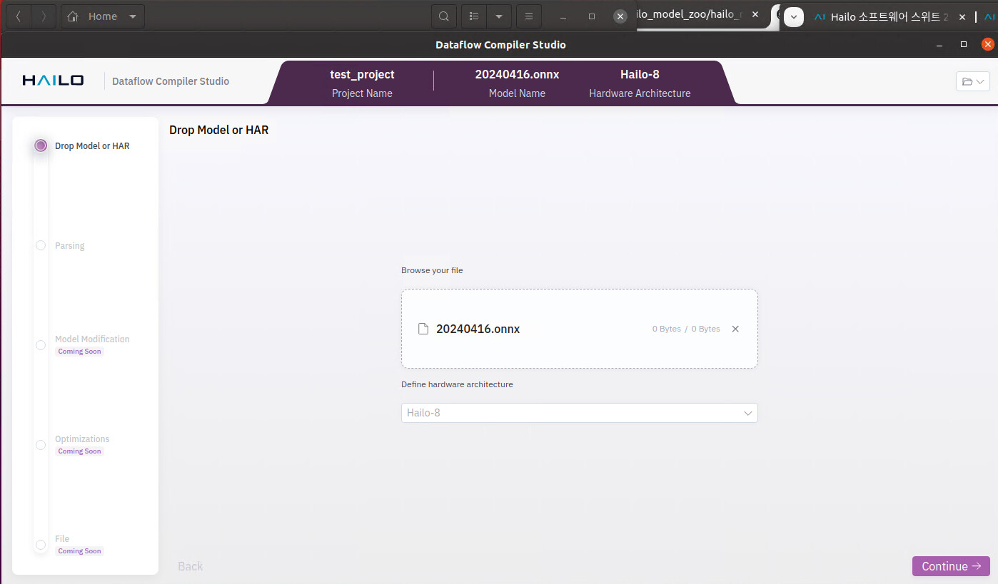

Hailo DFC Version: 3.28.0 can’t open onnx files. I can’t upload by dragging the onnx file.
Even if I drag and drop the onnx file to upload it, it is 0 bytes. I can’t proceed any further.
Hi @hcpark
Are you running dfc-studio from the suite?
If so, maybe the file is not located in the Docker.
As you said, it doesn’t run in docker, but it works when I install it manually. Thank you.
