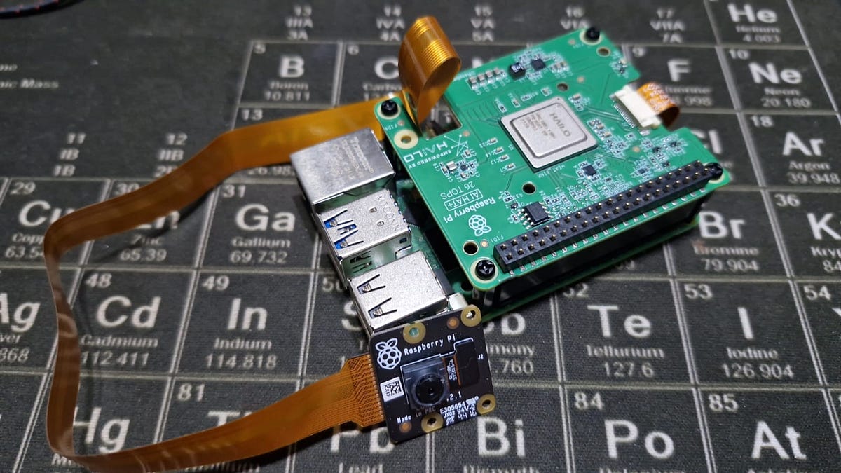

I’m starting to play with the AI Hat+ .
I found it challenging to convert my custom model to HEF. Thus, I wrote a minimum step list to perform this conversion using Docker:
or without Docker:
I’ve been using these tutorials since then to convert my models, but since I’m just a beginner with Hailo consider find glitches.
I’d appreciate it if someone could review and contribute with fixes.
