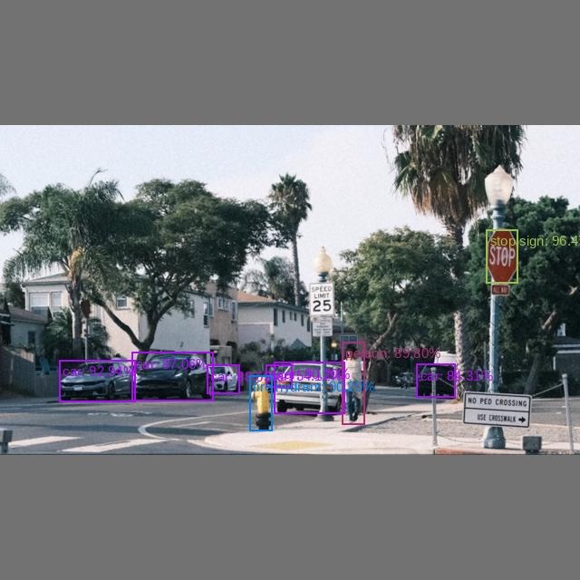

Getting object detection working:
I’ll be using the example here: https://github.com/hailo-ai/Hailo-Application-Code-Examples/blob/main/runtime/python/object_detection/README.md
git clone https://github.com/hailo-ai/Hailo-Application-Code-Examples.git
cd Hailo-Application-Code-Examples/runtime/python/object_detection
uv pip install -r requirements.txt
Follow the instructions in the README.md there. I found there were two problems:
- The model they download in
download_resources.shis not correct, I think it’s for4.17instead of4.18. I found the correct model in the model zoo repository. Seeyolov7and download theCompiledmodel. You can run this command:curl https://hailo-model-zoo.s3.eu-west-2.amazonaws.com/ModelZoo/Compiled/v2.12.0/hailo8l/yolov7.hef -o yolov7.hef, overwriting the previous download if you have it. - There is an error with
CHECK failed - max_desc_page_size given 16384 is bigger than hw max desc page size 4096. I fixed this by creating the file/etc/modprobe.d/hailo_pci.confand includingoptions hailo_pci force_desc_page_size=4096in it.
After these fixes, I can run ./object_detection.py -n ./yolov7.hef -i street.jpg on my own image, stree.jpg and it works.
