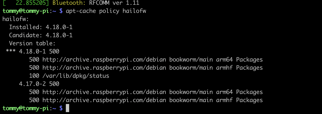

Hi Guys, Im facing some issue with firmware version, I’m working in a RPI5 freshly installed, I follow oficial RP doc, I installed driver through apt, it’s installing 4.18 but in the dmesg is showing that hailo is searching for the 4.19, someone can give my a clue on this. I download manually the 4.19 paste it, but when I ran hailocli command it’s failling due to a mismatch version between firmware and cli.

Hey @tommymcphillips ,
This issue seems to be from the updating to 4.19 , are you still facing this issue ?
I have the same error. And yes, I’m still facing it.
@omria
Really weird, I solved it by installing a new raspberry OS, double checking all the steps (all the time checking dmesg after a step). but not sure how I installed the version 4.19 through apt if my apt-cache policy was showing 4.18 in my previous raspberry OS instance. the diff between both installation is that in the first I installed the camera, and then the hailo, and now the first thing that I did was Hailo drivers. :person_shrugging:
