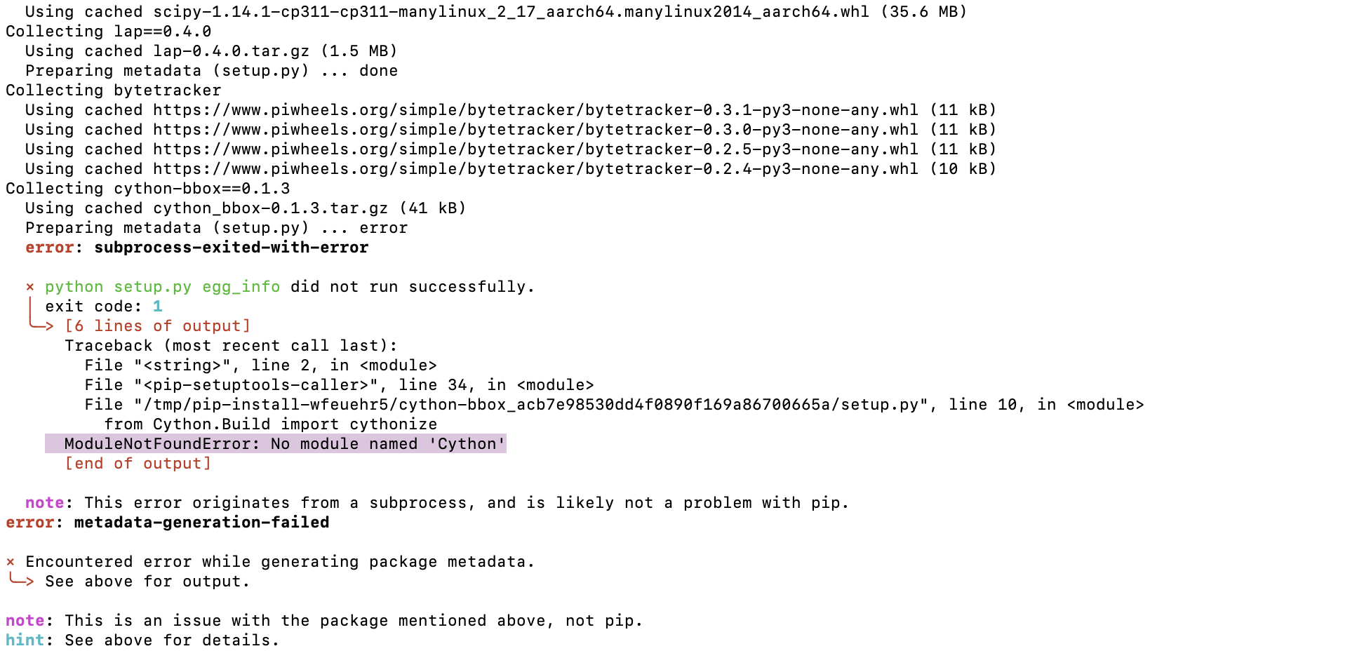

I create virtual environment and install hailort-4.18.0-cp311-cp311-linux_aarch64.whl successfully but when i start in
install pip install -r requirements.txt many error had faced
1- ModuleNotFoundError: No module named ‘Cython’
2- installed Cython then repeat pip install -r requirements.txt
but i faced this error

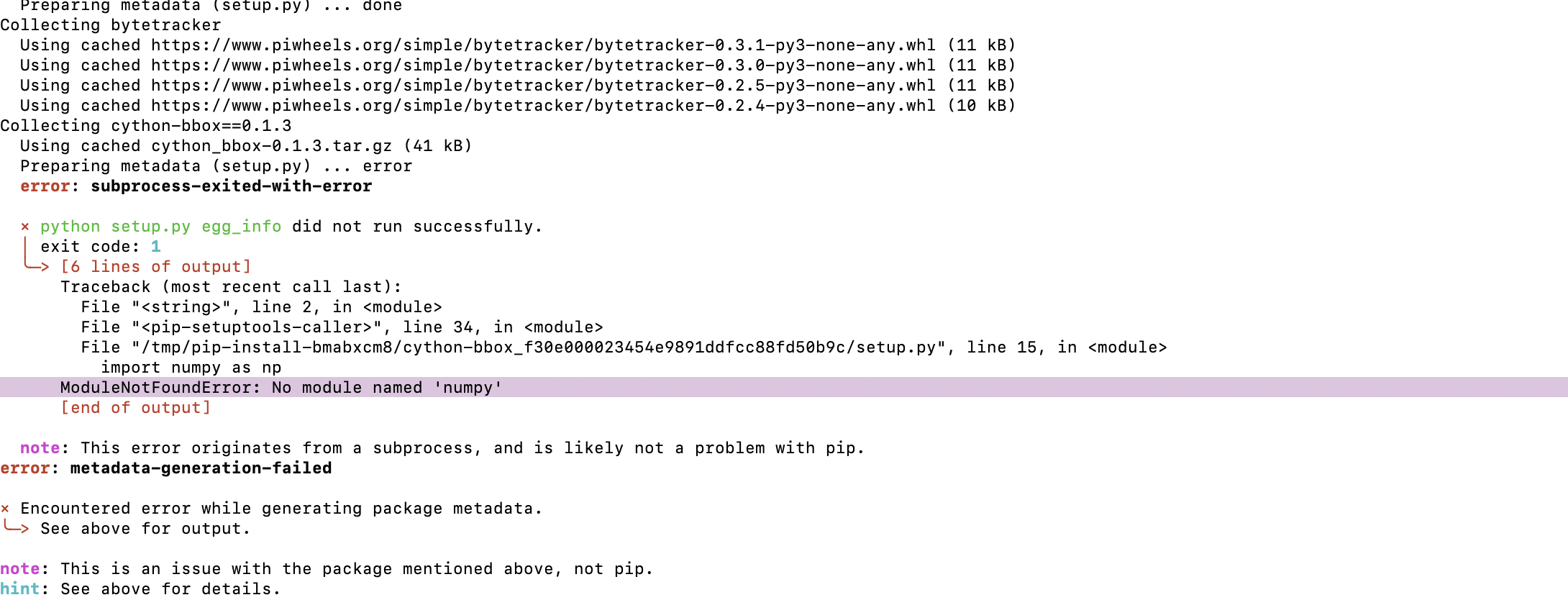

ModuleNotFoundError: No module named ‘numpy’
2- installed numpy then repeat pip install -r requirements.txt
but i faced another error
