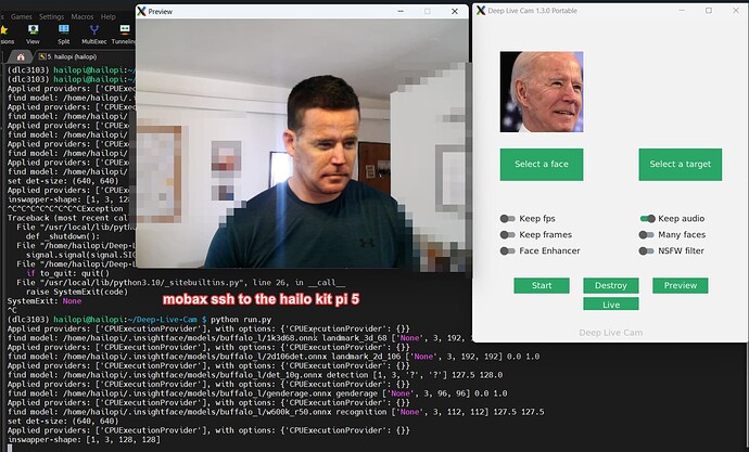

Last week I have encountered this post showing a very cool realtime face swapping:
Link to project: GitHub - hacksider/Deep-Live-Cam: real time face swap and one-click video deepfake with only a single image

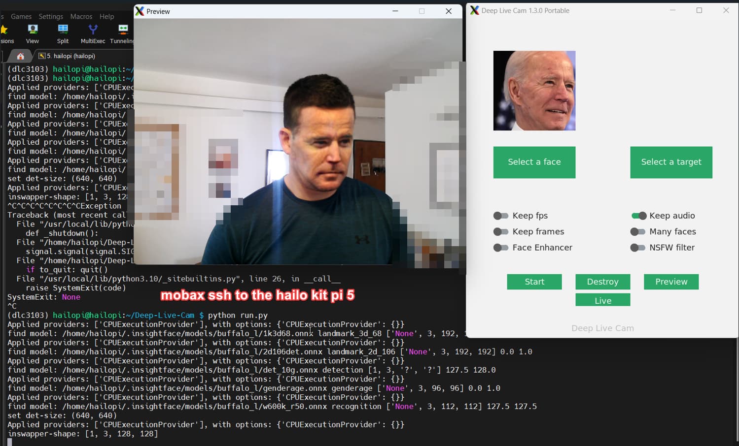

After succeeding running it on a Macbook, I have tried making it work on my RPI5+AI kit.
It took me the weekend, but I was eventually able to make it run, even if very laggy:
This wonderful project is able to run on โ€œsimpleโ€ machines, not just heavily reinforced with GPU.
As far as I understand, it unfortunately not harnessing any of the Hailo 8L abilities at the current configuration,
are there members here that have experimented with such libraries and applications over the Pi5+8L kit?
Any similar projects that have done this that are a good reference?

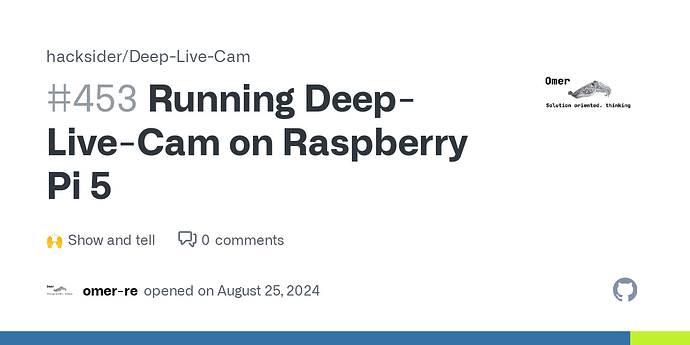

Link to โ€œhow to set the project to RPI5โ€
