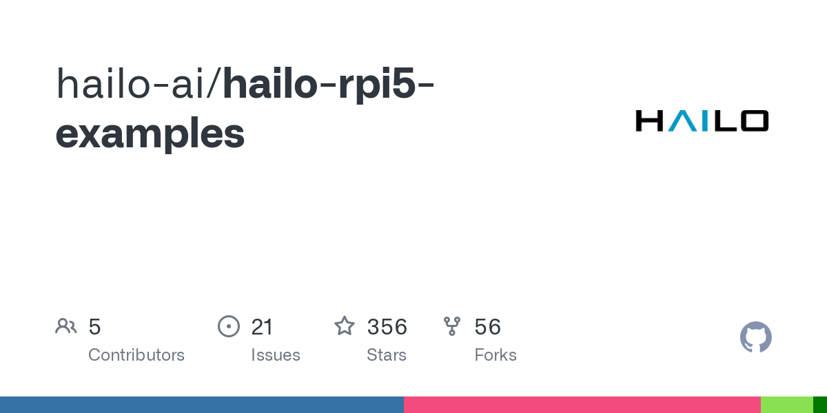

In fact, they are different things. The models used for facial recognition and object detection are not the same. Furthermore, the official AI kit does not currently support facial detection on the Raspberry Pi. Here is the link:
If you want to start an AI project, I recommend beginning with object detection.

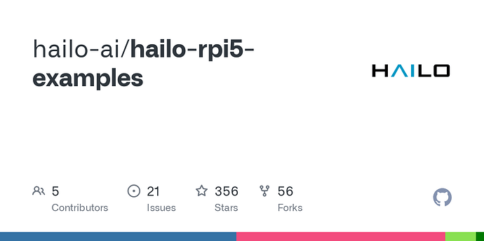

No, it is nothing about training a model, it is about to develop a model on raspberrypi.
You can see not pipeline about face recognition.
Hi @oktober.yildiz , what @jiahao.li is saying is there is no out-of-the-box example application for face recognition in our Raspberry Pi 5 examples repository.
We do have customer that created biometrical face recognition application based on Hailo. We also do have face detection models in our ModelZoo:
GitHub - Hailo Model Zoo - Hailo-8 Face Detection
and we do have face recognition examples in our TAPPAS repository.
GitHub - Tappas - Face Recognition
But they will require a little effort to get running on the Raspberry Pi.
