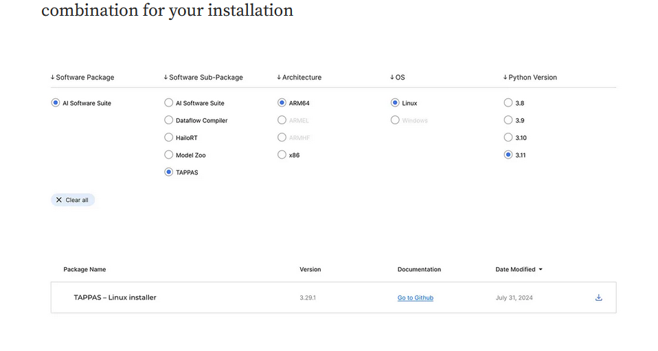

A few notes worth updating:
- at least for me, all apt-get and dpkg commands required sudo, even when you didn’t write them as such.
$ pip3 install hailort-4.18.0-cp311-cp311-linux_aarch64.whlrequired activating the venv first, otherwise it refused.- downloading TAPPAS is currently available for x86 only, I assume it changed since you took the screenshot, which shows the option for arm64 as well. That is the current state:
