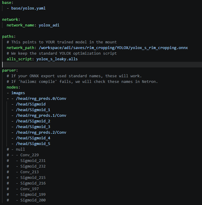

I ran into the same issue and still haven’t found a solution. How did you fix it? Thanks!
I’m getting the same error, trying to run a compiled HEF of YOLOX-s. I followed the instructions here hailo_model_zoo/training/yolox/README.rst at master · hailo-ai/hailo_model_zoo · GitHub
And modified the YAML file to contain the new layer names generated by the ONNX
Did you ever find a solution?
