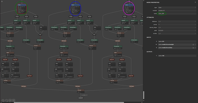

- In the case of
yolov5n_seg, download our pre-trained model from model explorer .
Open the downloadedonnxusing Netron and search (usingctrl + F) the layer names you found earlier.
- In the case of

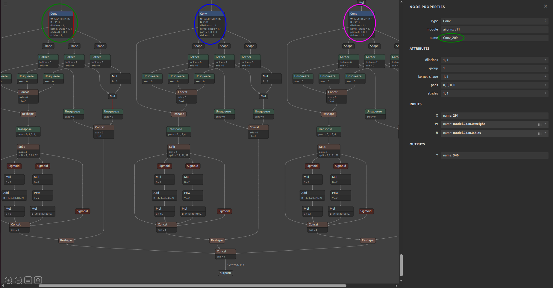

- Map to your own ONNX
Open your own
onnxusing Netron -
Find the equivalent layers and their names — these will be your
end_node_names.
