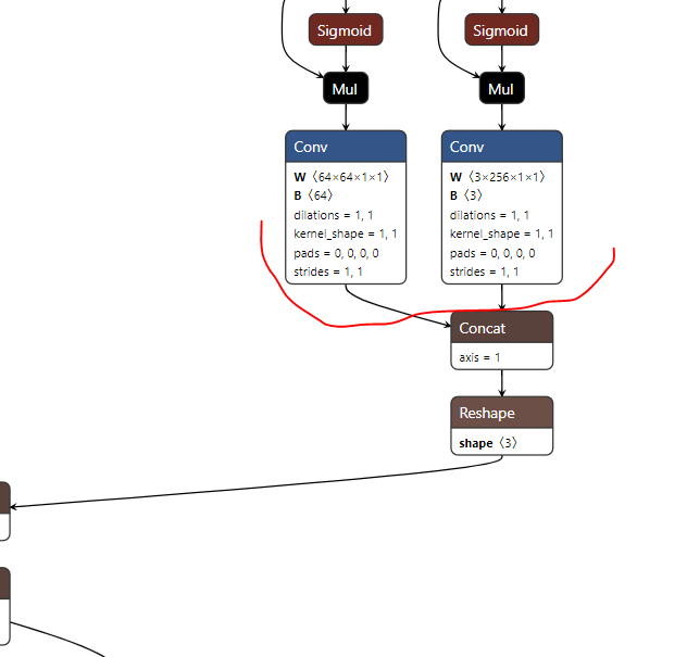

Hi @user54,
The error states that there are some unsupported operations in the model that the Hailo Parser doesn’t support.
If you look at the end of the error message, it gives you the suggestion of what end nodes you should provide.
As a rule of thumb, the end nodes for the parser should be the last neural layers of the model, e.g. the last layers before the postprocessing of the model starts.
Regards,
Changing the end layers to the suggested ones brought me some steps further.
Thanks for your hint, Omer.

Hi @user54,
I suspect that the proposed end node names by the Parser are not good. Can you please send me the ONNX itself so I can take a look?
Regards,
Sure. I added the onnx file to the shared folder. Link via DM.
Best regards, Stephan
Hi @user54,
As I suspected, the issue was that the parser suggestion were not good.
The end nodes you need to provide are these:
/model.22/cv2.0/cv2.0.2/Conv
/model.22/cv3.0/cv3.0.2/Conv
/model.22/cv2.1/cv2.1.2/Conv
/model.22/cv3.1/cv3.1.2/Conv
/model.22/cv2.2/cv2.2.2/Conv
/model.22/cv3.2/cv3.2.2/Conv
If you open the ONNX in Netron, you can see that the end nodes I chose are the ones just before the start of the postprocessing ops. For example:
Once you provide the Parser these end nodes, you’ll see that it would work (you can also add Hailo NMS to this model. Please see “nms_postprocess” in the Dataflow Compiler user guide and the relevant yolov9 .yaml in GitHub - hailo-ai/hailo_model_zoo: The Hailo Model Zoo includes pre-trained models and a full building and evaluation environment).
Regards,
