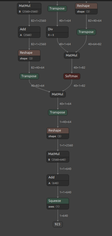

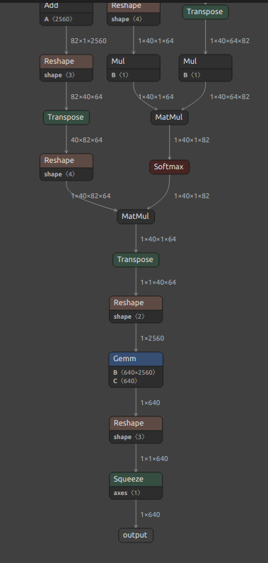

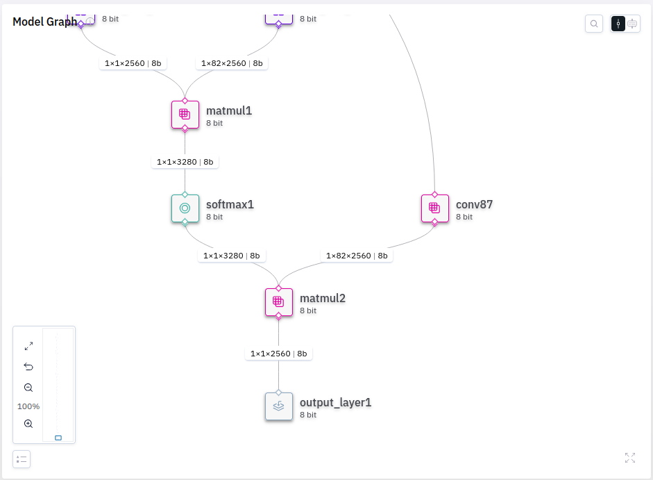

Hey @lihis,
i tried to compile the visual part with DFC 3.28.0.
I got this error:
hailo_sdk_client.model_translator.exceptions.ParsingWithRecommendationException: Parsing failed. The errors found in the graph are:
 UnsupportedShuffleLayerError in op /attnpool/Transpose_5: Failed to determine type of layer to create in node /attnpool/Transpose_5
Please try to parse the model again, using these end node names: /attnpool/MatMul_4
so i tried this code to compile it:
    str(onnx_path),
    onnx_model_name,
    end_node_names="/attnpool/MatMul_4"
This compiled. My question now is did i clip the rest of the graph which would come after /attnpool/MatMul_4 ?

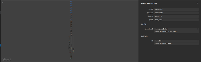

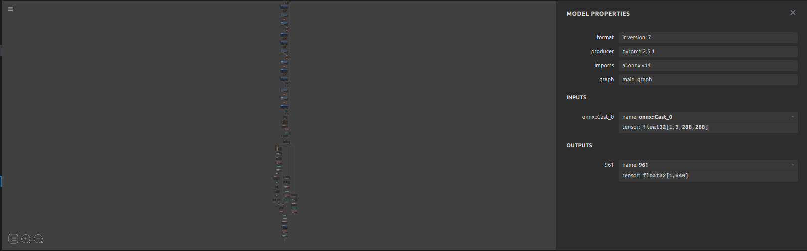

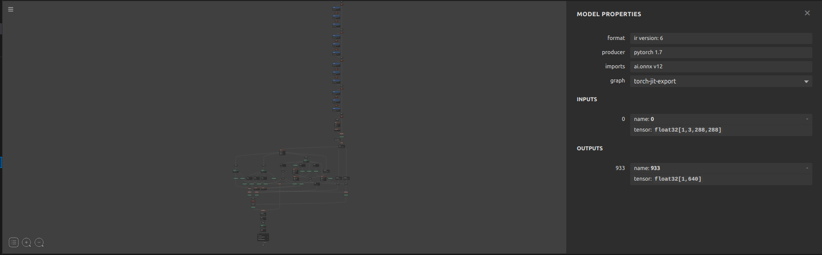

Hey @lihis,
First i tried to compile the onnx you have send me. It failed at the same point as my onnx file.
Then i checkd the installed packages.

I have a suspicion where the error lies.
After the compilation it looks like a network can only have 3 dimensions.
I saw this in the follow har file:
It is a compiled version of the RN50x4 network i got from my code. To compile it i cut of the last part.
This is the onnx file you sent me:
There we see the maximal number of dimensions is 3.
Now this is my onnx file:
There we see that after the MatMul block i got 4 dimensions.
The compilation fails at the Transpose layer after the MatMul block.
I suspect that the compiler combines the dimensions and then doesn’t know what to do at the transpose layer.
