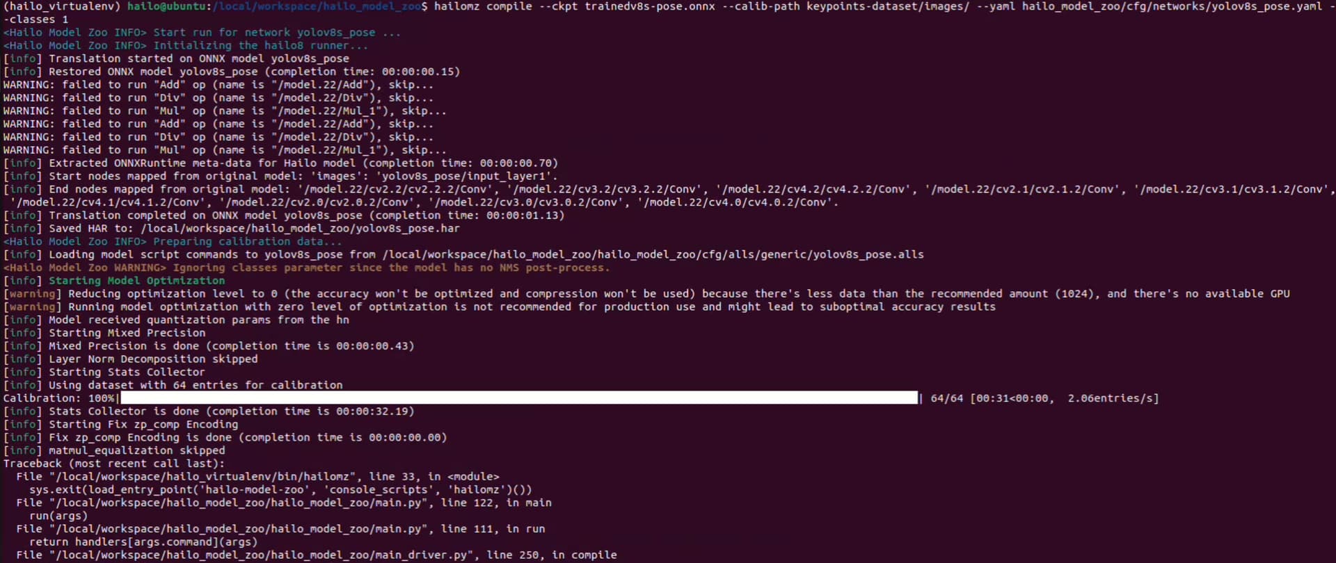

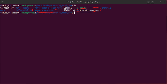

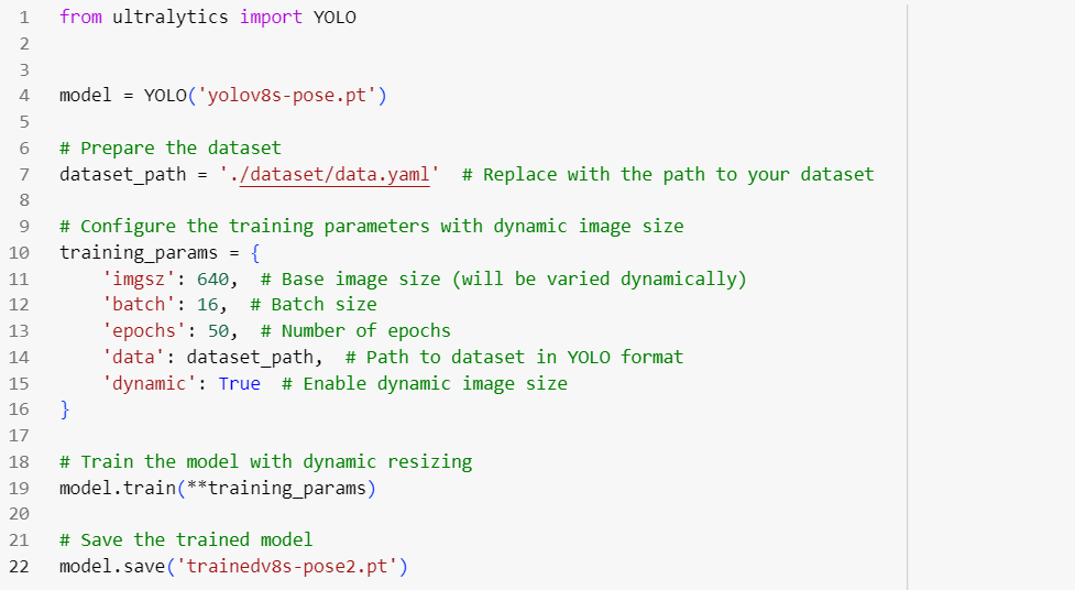

I have a custom trained model on yolov8s-pose. I trained and converted to onnx outside hailo env (hailo_model_zoo does not have training for pose model). And copied trained model and dataset into hailo env.
Next I run the compile command -
hailomz compile --ckpt trainedv8s-pose.onnx --calib-path keypoints-dataset/images/ --yaml hailo_model_zoo/cfg/networks/yolov8s_pose.yaml --classes 1

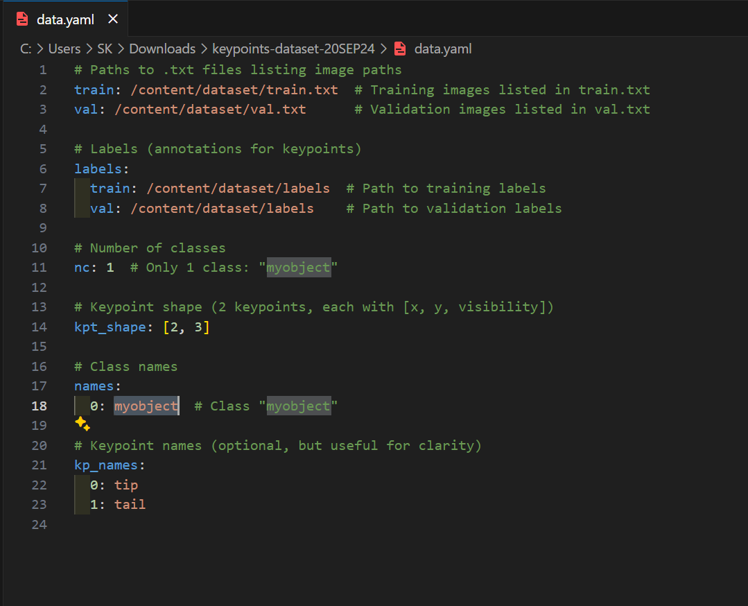

My dataset yaml

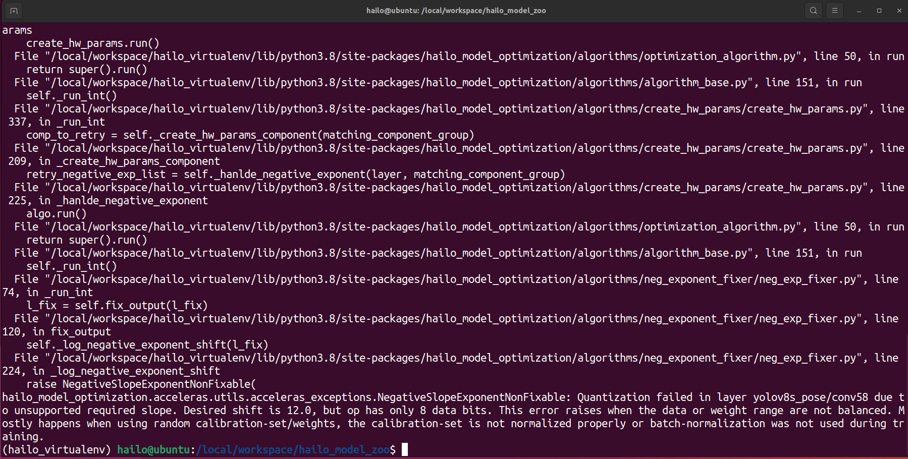

Once I run I get the error -

In the Previous I tried latest opset version.
Also Tried different onnx opset versions(11 and 13). Nothing changed. Same Error.

Hey I think I found where is the issue…
My training data contains images of resolution 640x360. And also my data contains 2 keypoints. And these things changes the output of the network. And I am considering those changes in yaml file. Probably this is the reason…

  1. what are the changes you have done during training yolov8pose]
