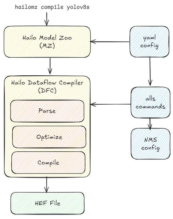

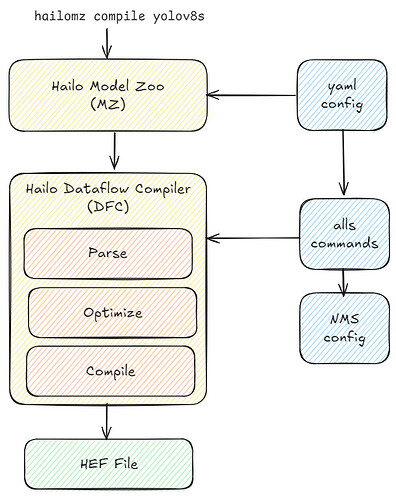

Hi @Thor,
Indeed there are multiple configuration and control files. Let me try to sort if out for you.
The yaml file is the Model-zoo configuration, it is the root that points to all other configuration and command files. See the below diagram.
The Model-Zoo further uses the Dataflow Compiler (DFC), the compile reads in an alls file as input commands, since NMS addition has many commands it was externalize into a seperate file.
