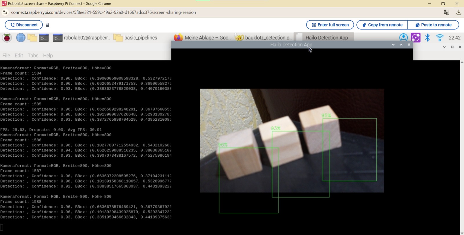

Hi @Nadav,
I trained a yolov8s model for square boxes, can you explain further what you mean with “input” if you referring to the the camera it’s always the raspberry pi camera module 3 camera, when you mean the dataset the pictures were taken from my phone camera and the raspberry pi camera module 3 I created a data set in roboflow, my “old” Hef file got an pt model which dataset was not stretched to a square format, but the yolo training in Colab made it in a square format, I followed the following tutorial for the conversion from ONNX to HEF Raspberry Pi AI Kit: ONNX to HEF Conversion.
Since I didn’t use GPU the process took WSL2 with Ubuntu 22.04 3 and a half hours. So when I finally adjusted the jyson put my files in the right folders of the hailo_rpi5-examples folder, I saw the following outcome when I use the adjusted detection.py script (I am adding for you my json and detection.pipeline script):

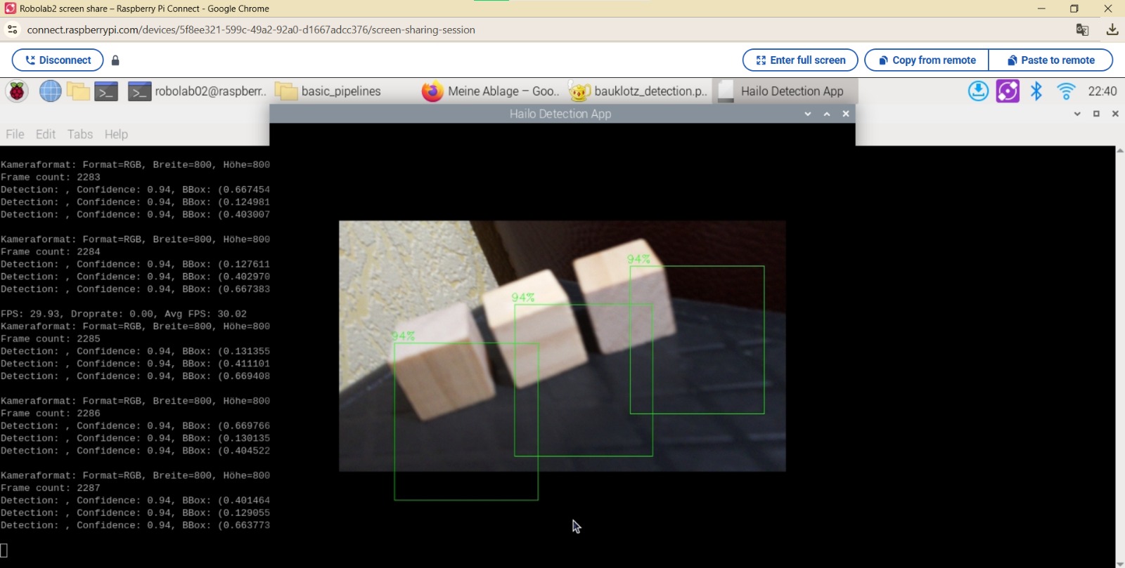

I initally thought maybe it can be a problem with the size, so I cropped all of my pictures to the format 800x800 and again trained a model had the onnx file ready, compiled it and in the end had near identical results as the other HEF File → Disoriented bboxes:
as you can see in the tutorial i linked there weren’t any alls just a “simple” command: “hailomz compile yolov8s --ckpt=cybest.onnx --hw-arch hailo8l --calib-path train/images --classes 2 --performance” , the images in “train/images” I used here were the ones I trained the model with.
I get also a bit confused to be honest, some in this forum are able to compile their model with one command like this colleague right here https://community.hailo.ai/t/how-to-modify-yolov8n-yaml-file-when-compiling-hailomz/5082/2 and other have to prepare three different files for the conversion, the nms_config.json, the yaml and another one… I really respect the people that do these kind of projects as their hobby. And I also see the fun in it but as I said, it soon will be three months since I started and I really want to end this project with a nice HEF file ![]()
