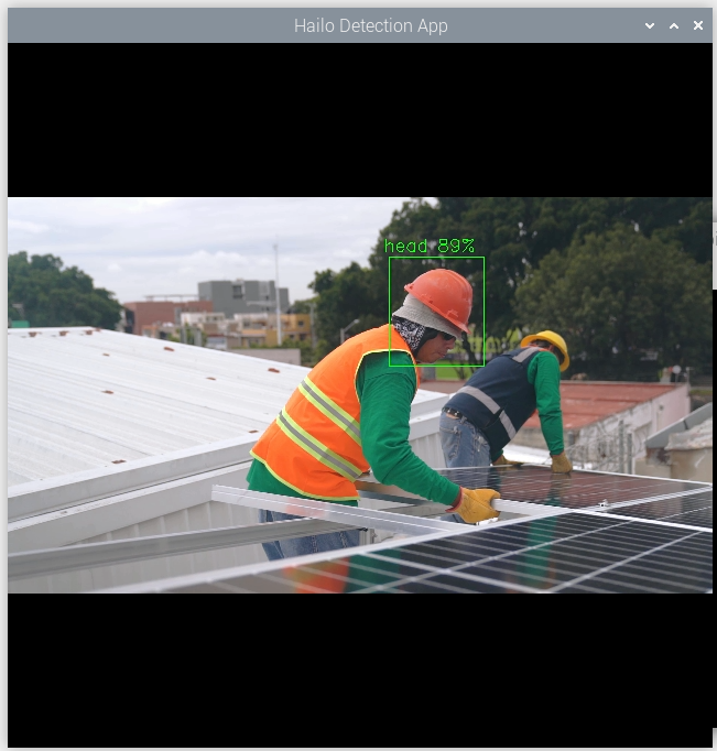

I have converted a yolo8 model to hef successfully and transfered the file to RPI and when I run the model the detection is wrong.
Verifying the same in yolo training results, it seems to have labelled correctly.
My command :
python basic_pipelines/helmet.py --labels-json helmet.json --hef resources/yolov8n.hef -i ~/Downloads/8853529-hd_1920_1080_24fps.mp4
The mp4 file has some workers with safety hats, but it is being detected as head :
How do i go about debugging this?

@nina-vilela Now it always shows helmet - even when there is no helmet on head. This is the helmet.json now :slight_smile:

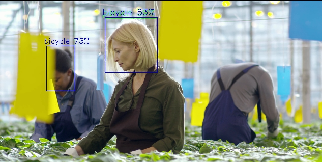

20240920_15h19m35s_grim
Detecting faces as bicycle :grinning: :dizzy_face:
Resolving Tappas Issues and Improving Detection
  1. Tappas Installation:
  • To resolve Tappas-related problems, install the latest version of Hailo-All
  • For best results, consider purging the existing Hailo Tappas installation before updating
  1. Addressing Incorrect Detections:
  • The detection issue you’re experiencing appears to be related to label mismatching in your custom model
  • It seems the model is incorrectly identifying faces as “byles” due to incorrect labeling during training
Recommendation: Review and correct the labeling in your custom model’s training dataset. Ensure that faces are properly labeled, and the “byles” label is applied to the correct objects. This should help improve the accuracy of your detections.
