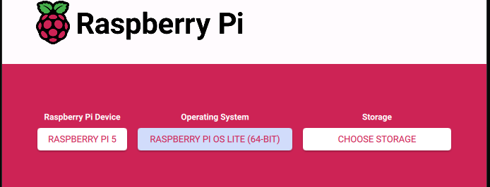

Its so weird i did a fresh install of raspbery pi lite os 64 bit
and also follow your installation step still i have the problem.
