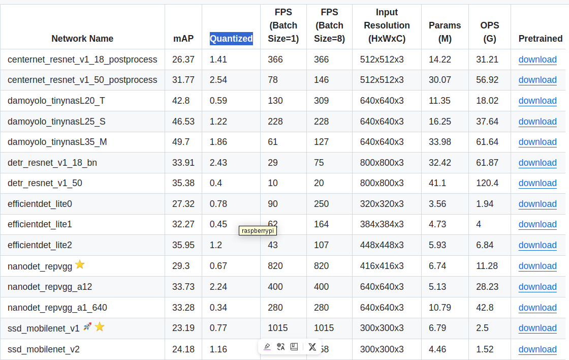

A question about quantized
What is the meaning of the quanzied number, most of model is positive:
But there is negative number:
So, what is the meaning of it?
Hey @jiahao.li
In this context, the “Quantized” number represents the degradation in model performance (often measured in terms of accuracy or mAP) due to quantization. Quantization is a technique where model parameters are reduced in precision (e.g., from 32-bit floating-point to 8-bit integers), typically to make the model run faster and use less memory. However, this process can cause a slight reduction in accuracy.
Here’s how to interpret the values:
  • Positive Values: These indicate the degradation percentage due to quantization. For example, a value of 1.41 means the model’s accuracy decreased by 1.41% after quantization. This is generally an acceptable trade-off for the efficiency gained.
  • Negative Values: A negative quantization degradation number, such as -2.54, implies that the model actually improved in accuracy after quantization. While rare, this can happen due to reduced overfitting or other quantization-related effects that, in some cases, can enhance model performance slightly.
In summary:
  • Positive quantized numbers = accuracy loss due to quantization.
  • Negative quantized numbers = accuracy improvement post-quantization.
