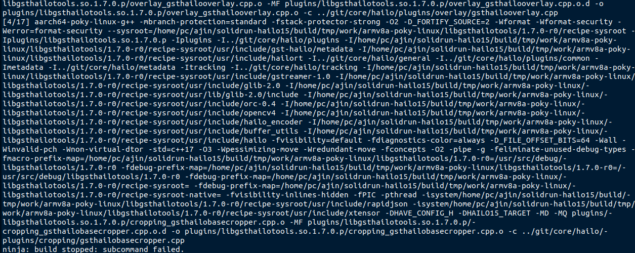

I’m working with Hailo15H(Hummingboard IIOT). I am facing an error while yocto build . I am attaching a snippet of log file along with this. Can anybody help to resolve this?

I have added the required appends in local.conf. But the build still fails. When I have dig through the /libgsthailo/5.0.0-r0/temp/log.do_compile, I found the following error message.
/build/tmp/work/armv8a-poky-linux/libgsthailo/5.0.0-r0/git/hailort/libhailort/src/rpc_callbacks/rpc_callbacks_dispatcher.cpp
{standard input}: Assembler messages:
{standard input}:25783: Warning: end of file not at end of a line; newline inserted
{standard input}:27331: Error: unknown pseudo-op: `.’
{standard input}: Error: open CFI at the end of file; missing .cfi_endproc directive
aarch64-poky-linux-g++: fatal error: Killed signal terminated program cc1plus
compilation terminated.
I’ve solved the issue bu downgrading the hailort on yocto build
