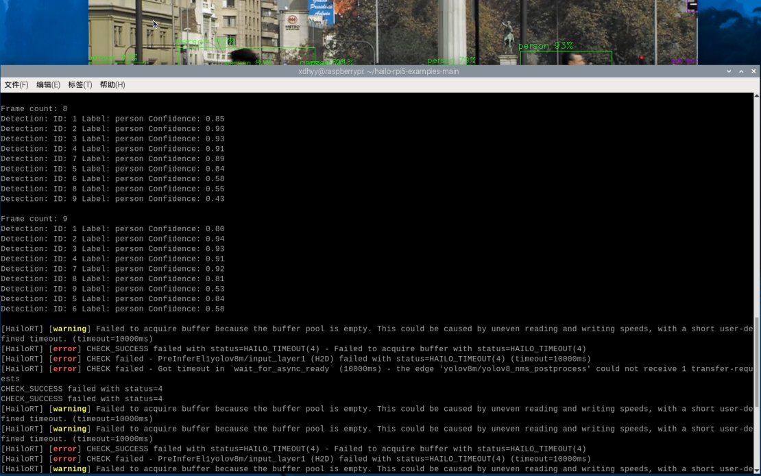

When running the official example on the Raspberry Pi 5 AI KIT, an error occurred: "Got timeout in 'wait for async ready' (10000ms)"
I have installed the relevant libraries on the Raspberry Pi 5 AI KIT (26tops) according to the Hailo Raspberry Pi 5 Examples tutorial.
When running python basic_piplines/detection.py , it can only run normally for less than a second before getting stuck, and the error is shown as in the figure.
Hey @zhao_yj,
The error message “PreInferEl1yolov8m/input_layer1 (H2D) failed with status=Hailo_timeout (4)” is related to a timeout during data transfer from the host to the Hailo device. The error occurs when a function exceeds the specified timeout duration.
Can you try running the following commands:
hailortcli scan
hailortcli run {this HEF}
This will help us check if the data transfers at the expected rate.
You might also want to try running hailortcli benchmark {this HEF}.
