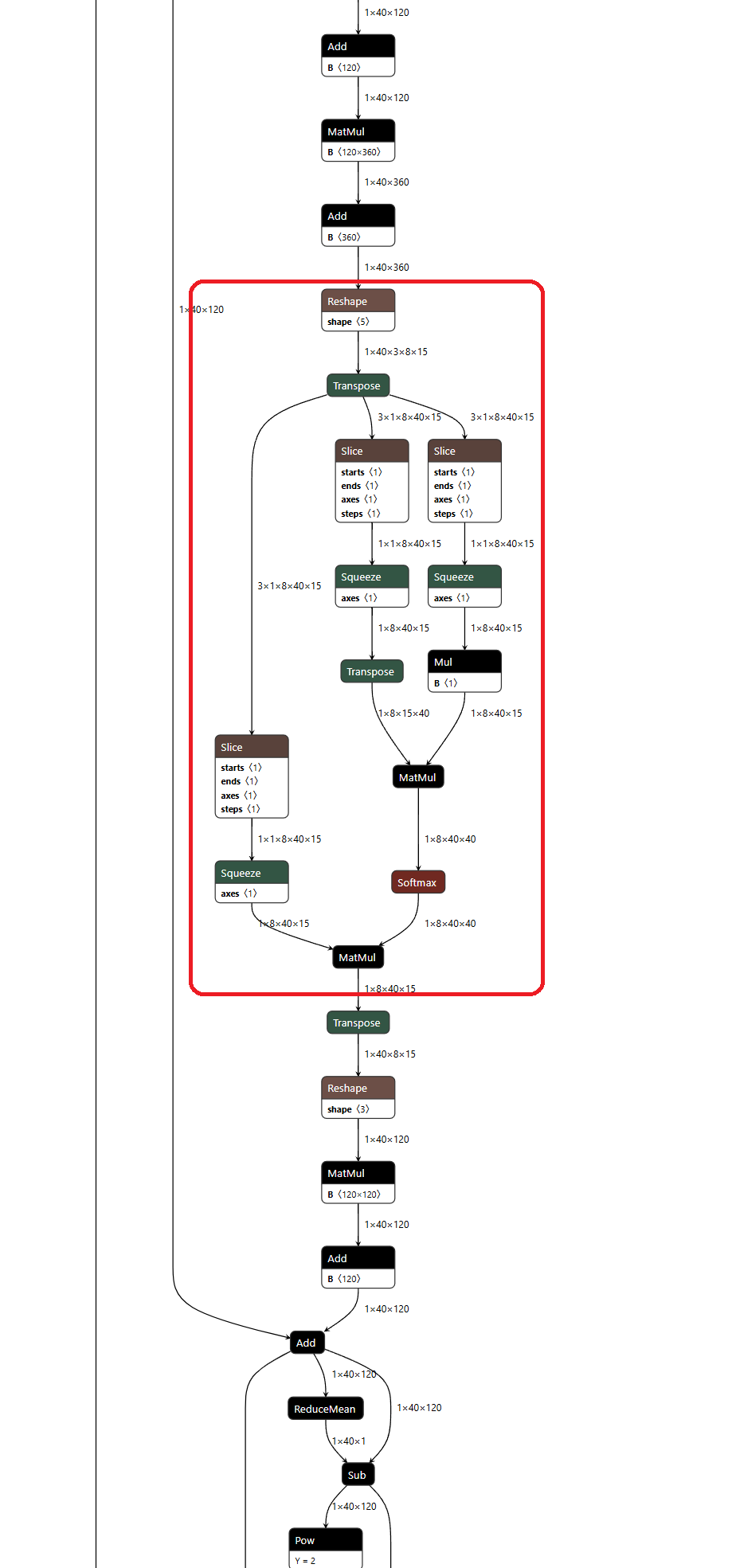

Then what I did like:
I removed those nodes with higher than 4-dimensional computation and softmax from the model, which means splitting the model into two sub models. Fortunately, both of these anomalies are in the same block.
[input] -> origin_model -> [output]
[input] -> sub_model_1 -> (compute on cpu) -> sub_model_2 -> [output]
