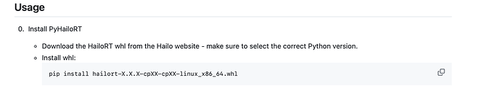

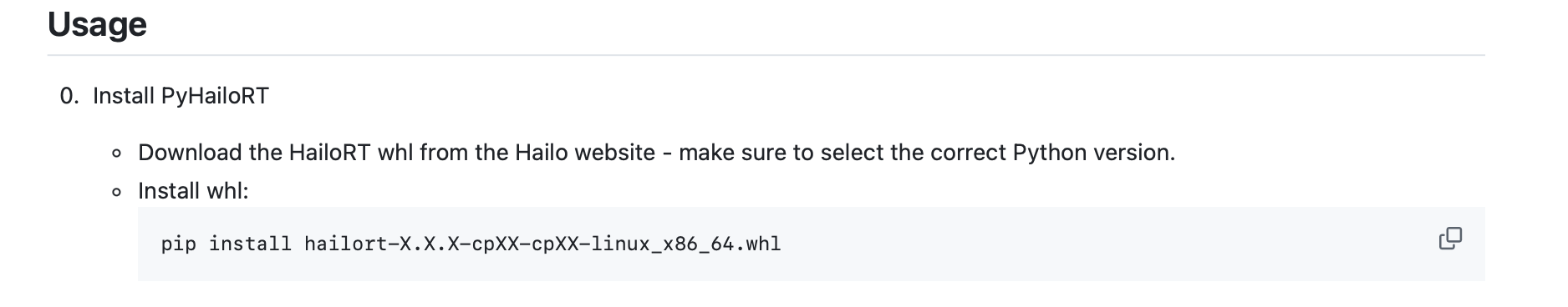

2- open Hailo-Application-Code-Examples/runtime/python/object_detection/README.md at main · hailo-ai/Hailo-Application-Code-Examples · GitHub
3- my problem now : i can not excite this step
  1. Install PyHailoRT
  • Download the HailoRT whl from the Hailo website - make sure to select the correct Python version.
  • Install whl:
pip install hailort-X.X.X-cpXX-cpXX-linux_x86_64.whl
when I run this command
pip install hailort-4.17.0-cp310-cp310-linux_aarch64.whl
4.17.0
i get this erro:
Looking in indexes: Simple index, piwheels - Simple index
Processing ./hailort-4.17.0-cp310-cp310-linux_aarch64.whl
ERROR: Could not install packages due to an OSError: [Errno 2] No such file or directory: ‘/home/rasai/kh/kh10/hailort-4.17.0-cp310-cp310-linux_aarch64.whl’

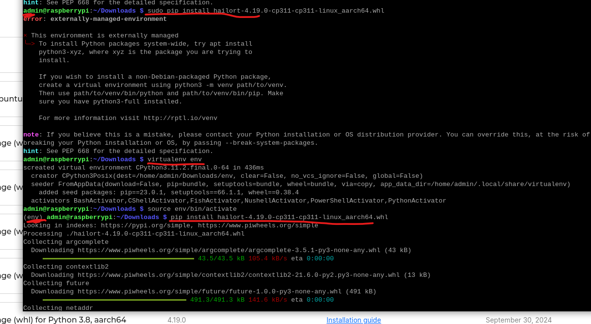

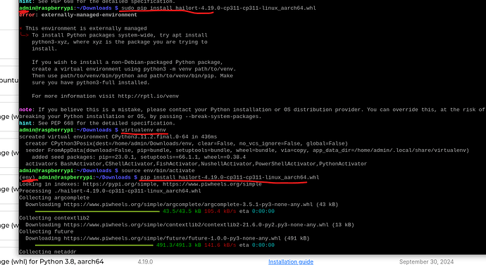

I still think, I never installed the hailort wheel manually, still everything works on my pi5.
I followed the raspberry pi guide to install. https://www.raspberrypi.com/documentation/accessories/ai-kit.html
Have you followed the same way to install hailo on your device?
Regarding Installation issue-
Please confirm your hailort file path.
Create a virtualenv to install.
