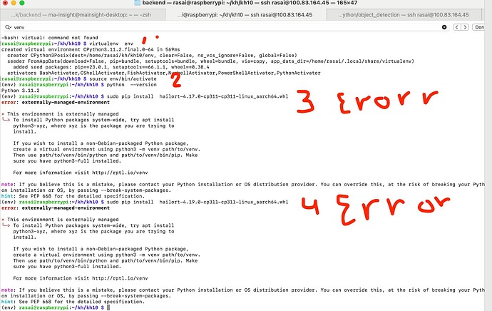

Test AI Kit by ssh connection command line

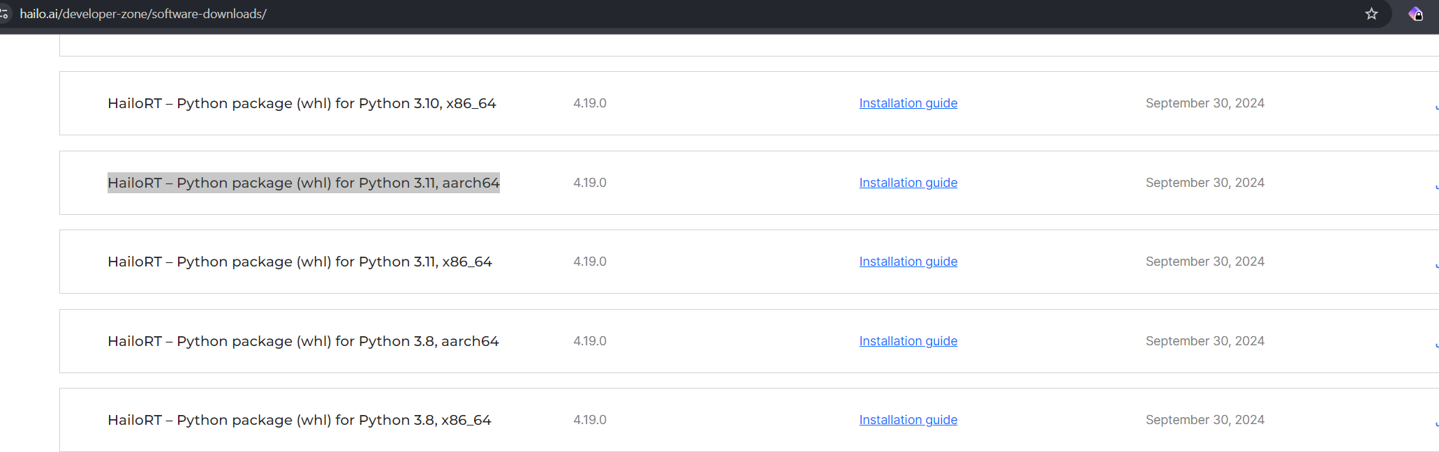

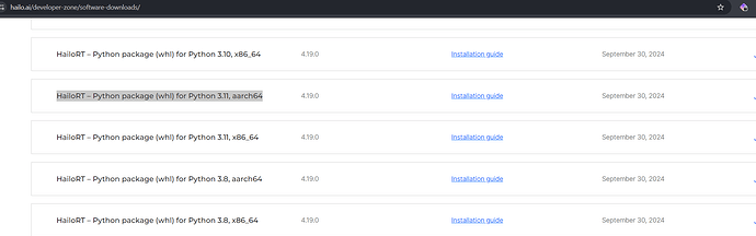

You have downloaded the correct aarch64 whl file from developer_zone?
Seems you’re trying to install without it…
I downloaded aarch64 whl file from here…
yes I followed the same way to install hailo on your device? look
then
can you send me this link please

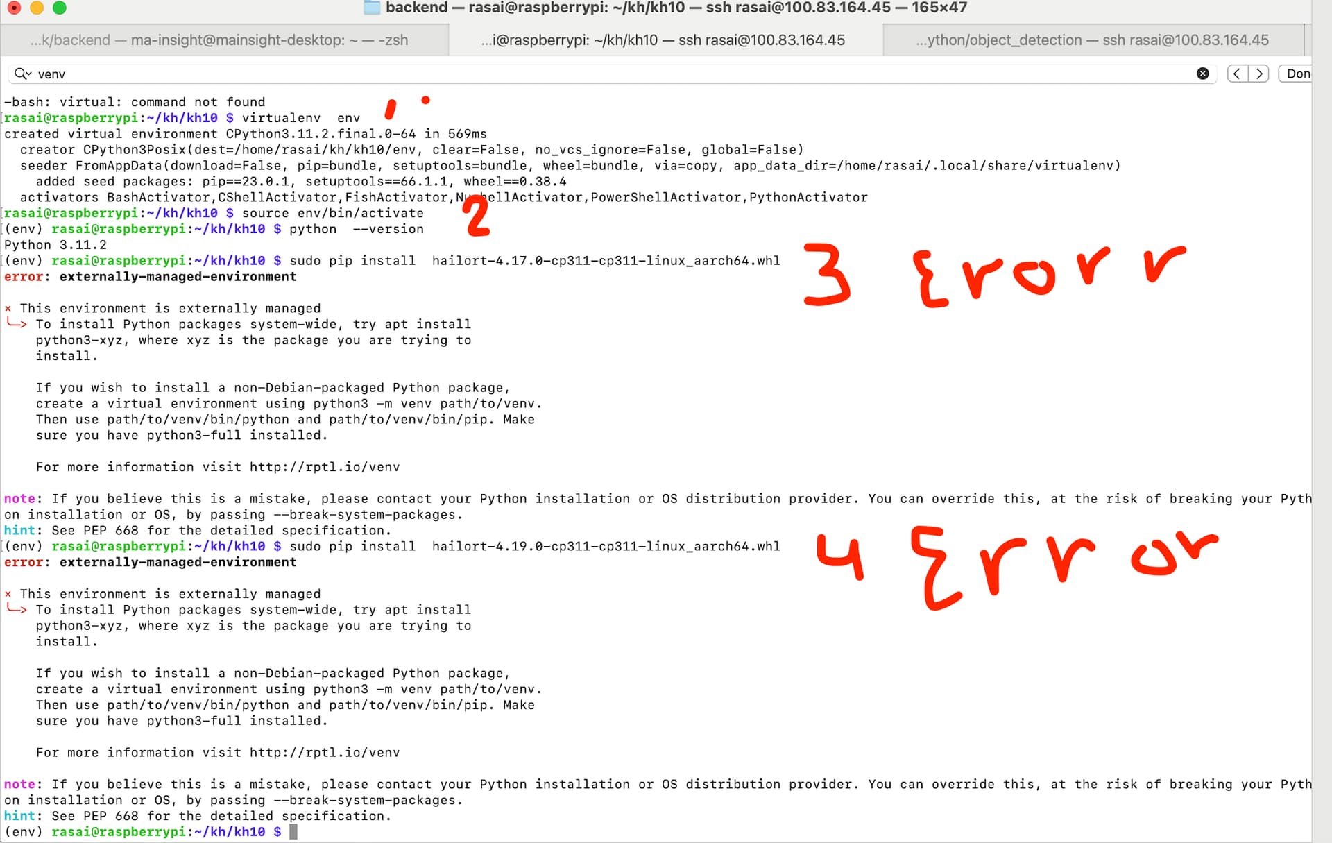

I do all steps but i can not install
@haldun

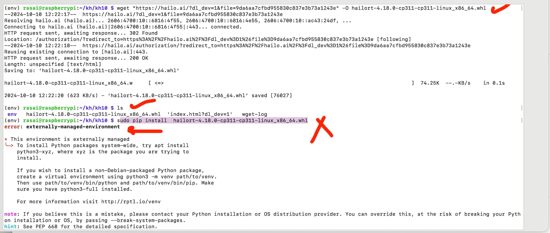

can you remove sudo before pip.
Second thing confirm you’re downloading the correct aarch64 wheel.
In your screenshot you are using x86.

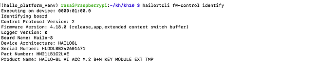

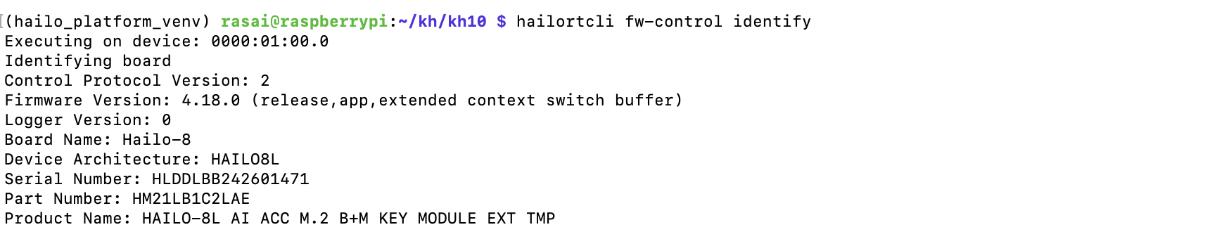

hello
finally I have done install : pip install hailort-X.X.X-cpXX-cpXX-linux_x86_64.whl
successfully

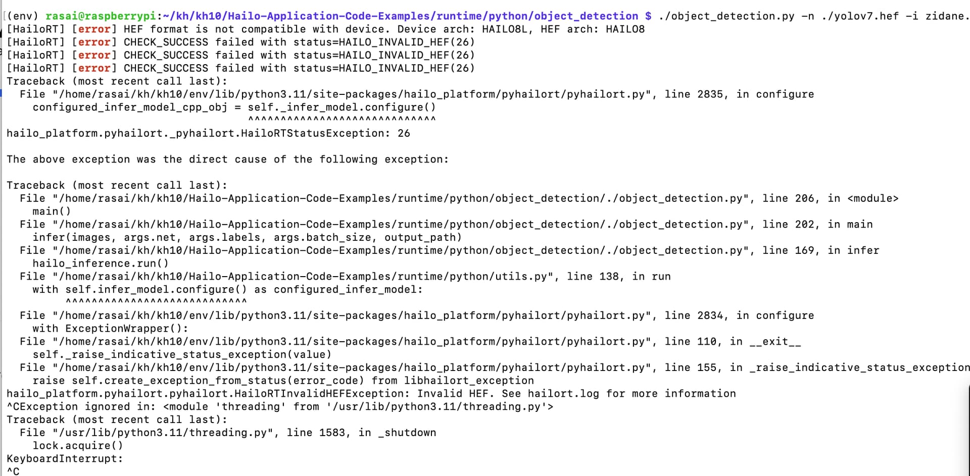

but in last command for test I get this error

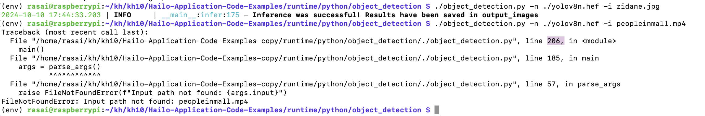

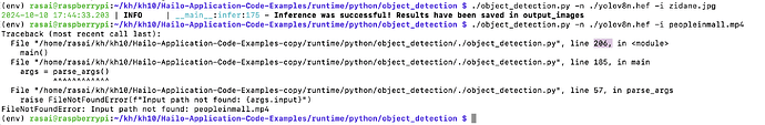

hello
https://github.com/hailo-ai/Hailo-Application-Code-Examples/blob/main/runtime/python/object_detection/object_detection.py
After implementing this example and resolving all issues, how can we continuously analyze a video or camera feed?" like this

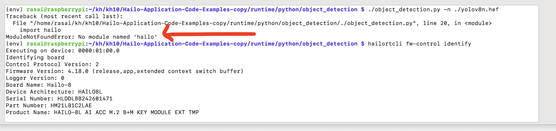

No module named ‘hailo’
import hailo
ModuleNotFoundError: No module named ‘hailo’

Hey @haldun
The latest error appears to be due to PYhailoRT not being installed in your virtual environment.
how I can install PYhailoRT installel in my virtual environment.
I remember installed on host machine when I put AIkit and test it by this command : sudo apt install hailo-all
(env) rasai@raspberrypi:~/kh/kh10/Hailo-Application-Code-Examples-copy/runtime/python/object_detection $ pip install hailort-4.18.0-cp311-cp311-linux_aarch64.whl i installed but same error : ModuleNotFoundError: No module named ‘hailo’
(env) rasai@raspberrypi:~/kh/kh10/Hailo-Application-Code-Examples-copy/runtime/python/object_detection $ python -c “import hailo_platform; print(hailo_platform.version)”
4.18.0
