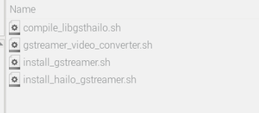

scripts folder has a few installation files,
  1. Did you install all of them?
  2. did it matter the order which you install them? In terms of dependencies
