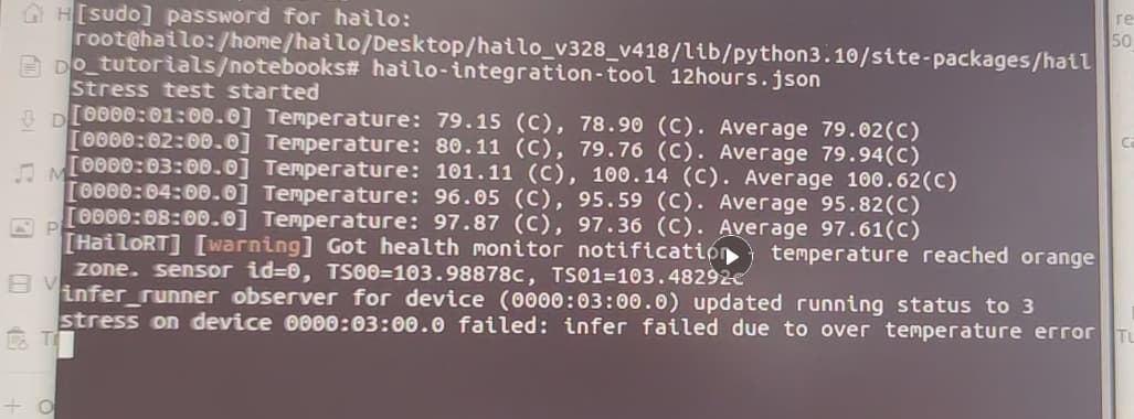

Hi Nadav,
when I am doing stress test on multi hailo-8 chips, it has the same thermal issue. But the error report didn’t indicate the process of reving down the clock and just killed the kernel.
it this the machanism of stress test or the clock-reving-down happened implicitly?
Hi @1042958010,
The throttling mechanism is implemented in the FW of each device, and as a result it’s unaware of additional Hailo-8 connected on the same system.
A scenarion that might have happened, that, the thermals are no handled and that the temperature increase is so rapid that the throttling is skipped and it is going straight to shut-off.
