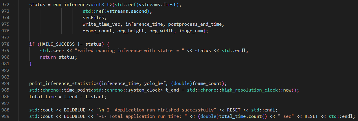

It has been built fine and operating without any problem but every time the program terminates with the last return statement at the last line of code,
return HAILO_SUCCESS;
the same error message keeps popping up. It doesn’t cause any visible harm or malfunction since it only happens when the application actually finishes its job, but since it keeps showing up, I got wondered what causes it and how to remove it.

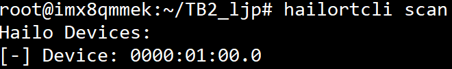

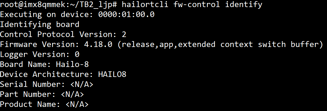

@omria Hello, I am going to share the output of the device scan, firmware identity and the version output first and then the result of the changed return statement.
2.
3.
4.

Unfortunately, the error still persists.
Again, this is the result from the un-edited code, built with ./build.sh and CMakeList.txt on the source directory.

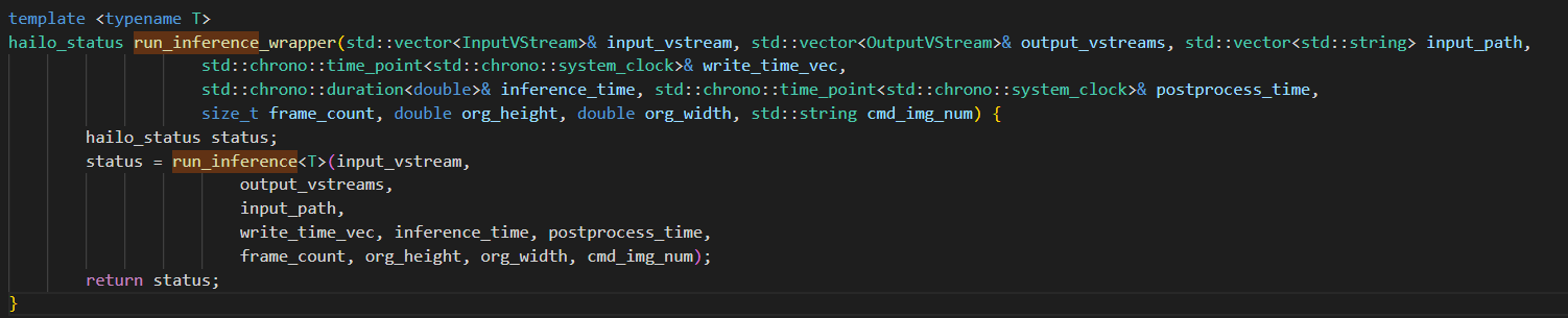

I wrapped the main routine one more time like
and called it on main, but the error still persists.
