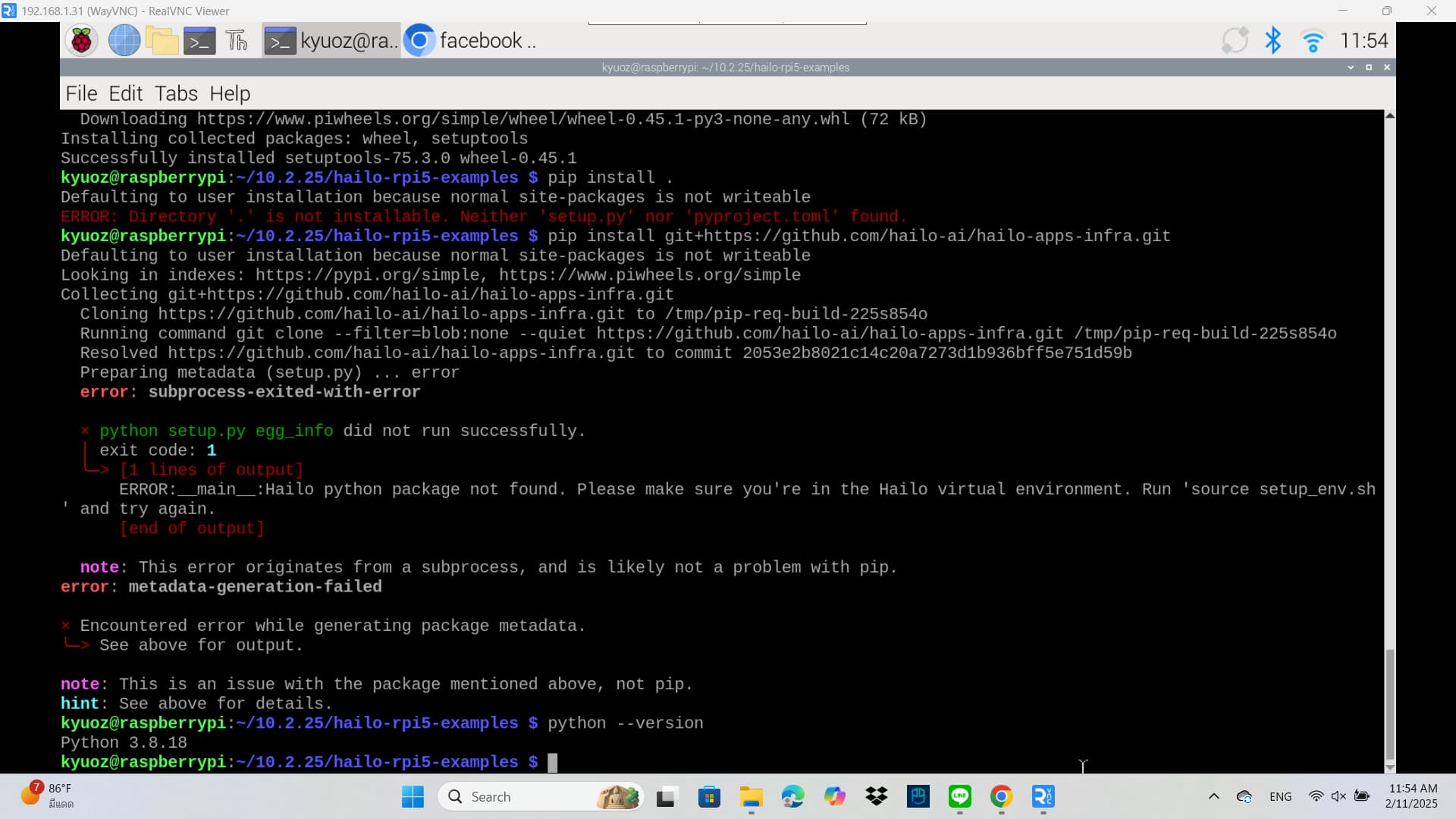

If you encounter errors while trying to run the examples, please remove the virtual environment and reinstall:
deactivate
rm -rf venv_hailo_rpi5_examples/
./install.sh
Now, restart the virtual environment and run:
source setup_env.sh
python basic_pipelines/detection.py
Note: If you performed any manual installations, you may need to remove some packages manually. Hopefully, this won’t be necessary.
