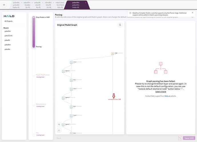

I used dfc-studio trying to parsing my custom trained model based on YOLOv9-m but got the message " Graph parsing has been failed. "
Here is the download link of my custom yolov9-m onnx model.
What’s possible root cause of this issue?
Another question, it looks like there are two start nodes “Conv_0” and “Conv_0” using Netro and complex multiple end nodes. How to set the start node and end node in parsing stage for this model?

Hello @omria ,
Sorry, I tried to get the logs but failed. The “Error Details” pop-up won’t let me copy the information. From Netron or dfc-studio, the graph show there are two start nodes. So don’t know how to put the start node in the parsing code, just put the “Conv_0” to parse this model is okay or not.
