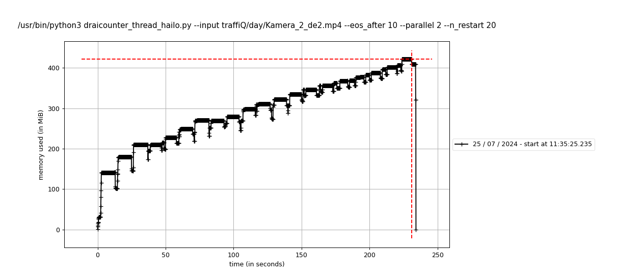

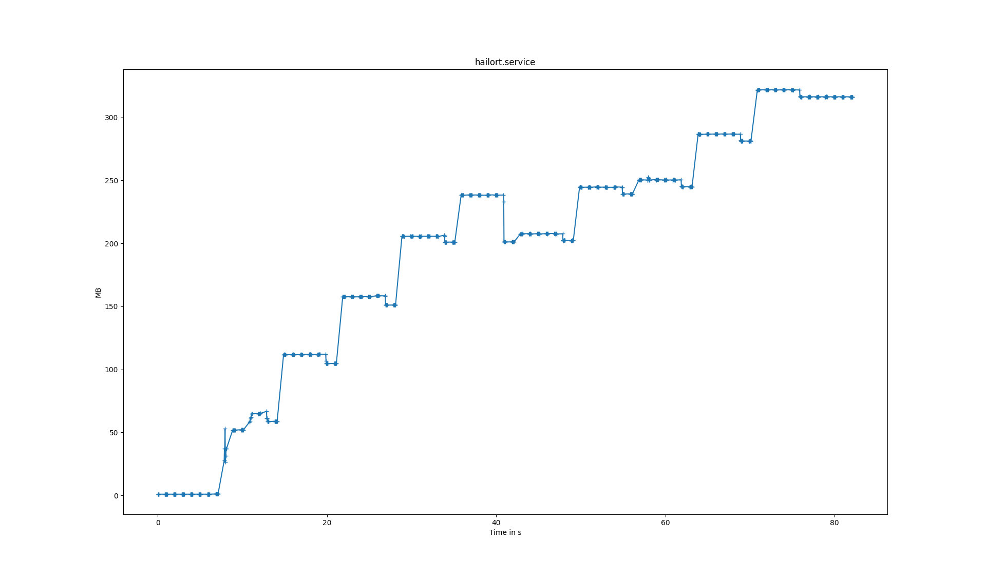

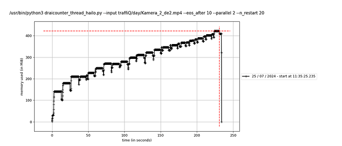

I might have found a possible memleak in hailort.service running under yocto. Now I’m aware that hailort.service is not officially supported for yocto. I’d still appreciate any help since we’re dependent on running multiple models in parallel.
My setup includes a python script which continously restarts a gstreamer pipeline 10 times and sends EOS after 5 seconds. I track the memory of the gstreamer pipeline using memory_profiler as well as hailort.service.

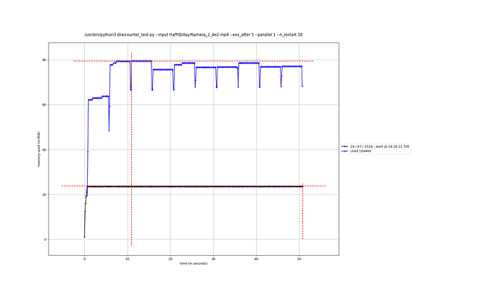

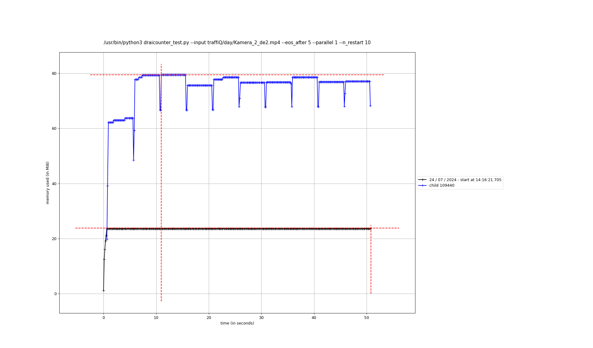

  1. Test running hailonet without hailort.service
    Pipeline: videotestsrc ! hailonet ! fakesink
No apparent memleak.

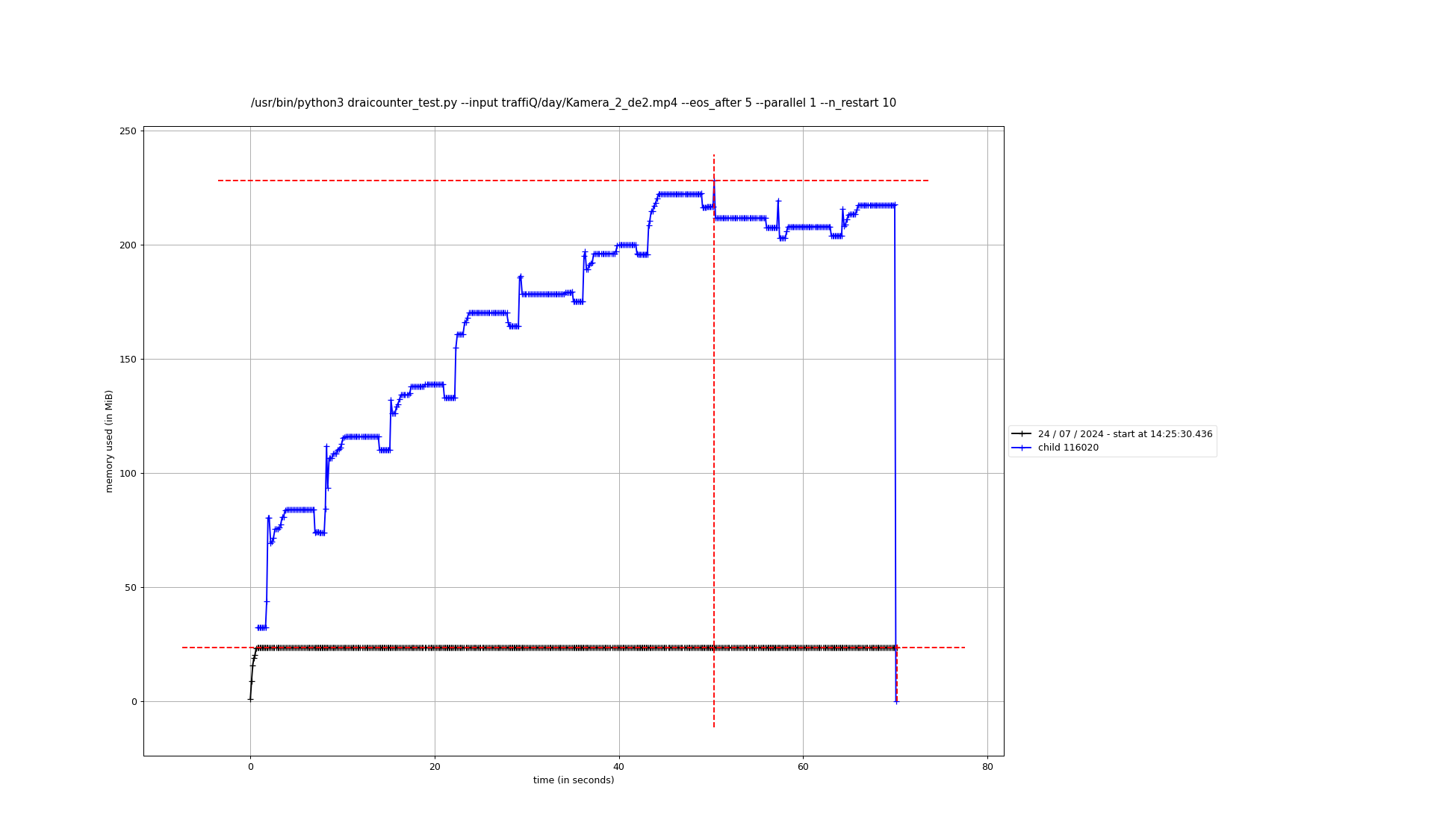

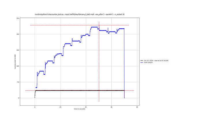

  1. Test running hailonet with hailort.service
    Pipeline: videotestsrc ! hailonet multi-process-service=true vdevice-group-id=1 ! fakesink
And here is a valgrind report of hailort.service.

==137814==    by 0x496E67: grpc_core::Executor::InitAll() (in /usr/local/bin/hailort_service)
==137814==    by 0x558DF7: grpc_iomgr_init() (in /usr/local/bin/hailort_service)
==137814==    by 0x4CFB53: grpc_init (in /usr/local/bin/hailort_service)
==137814==    by 0x350AD3: grpc::ServerCredentials::ServerCredentials() (in /usr/local/bin/hailort_service)
==137814==    by 0x3392AF: grpc::InsecureServerCredentials() (in /usr/local/bin/hailort_service)
==137814==    by 0x2EE6B7: RunService() (in /usr/local/bin/hailort_service)
==137814==
==137814== 320 bytes in 1 blocks are possibly lost in loss record 583 of 642
==137814==    at 0x486A790: calloc (vg_replace_malloc.c:1328)
==137814==    by 0x4010DD7: calloc (rtld-malloc.h:44)
==137814==    by 0x4010DD7: allocate_dtv (dl-tls.c:375)
==137814==    by 0x4011843: _dl_allocate_tls (dl-tls.c:634)
==137814==    by 0x549119F: allocate_stack (allocatestack.c:428)
==137814==    by 0x549119F: pthread_create@@GLIBC_2.34 (pthread_create.c:647)
==137814==    by 0x5906BB: grpc_core::Thread::Thread(char const*, void (*)(void*), void*, bool*, grpc_core::Thread::Options const&) (in /usr/local/bin/hailort_service)
==137814==    by 0x4A2727: ??? (in /usr/local/bin/hailort_service)
==137814==    by 0x4CFB97: grpc_init (in /usr/local/bin/hailort_service)
==137814==    by 0x2AB13F: main (in /usr/local/bin/hailort_service)
==137814==
==137814== 320 bytes in 1 blocks are possibly lost in loss record 584 of 642
==137814==    by 0x4A3073: ??? (in /usr/local/bin/hailort_service)
==137814==    by 0x5904EF: ??? (in /usr/local/bin/hailort_service)
==137814==    by 0x54906F7: start_thread (pthread_create.c:442)
==137814==    by 0x54F7CDB: thread_start (clone.S:79)
==137814==
==137814== 320 bytes in 1 blocks are possibly lost in loss record 585 of 642
==137814==    by 0x51EF367: std::thread::_M_start_thread(std::unique_ptr<std::thread::_State, std::default_delete<std::thread::_State> >, void (*)()) (in /usr/lib/libstdc++.so.6.0.29)
==137814==    by 0x498B40F: thread<hailort::MonitorHandler::start_mon(const string&)::<lambda()> > (std_thread.h:143)
==137814==    by 0x498B40F: hailort::MonitorHandler::start_mon(std::__cxx11::basic_string<char, std::char_traits<char>, std::allocator<char> > const&) (monitor_handler.cpp:190)
==137814==    by 0x49C1A27: execute_trace<hailort::MonitorStartTrace, std::__cxx11::basic_string<char, std::char_traits<char>, std::allocator<char> > > (tracer.hpp:53)
==137814==    by 0x49C1A27: trace<hailort::MonitorStartTrace, std::__cxx11::basic_string<char, std::char_traits<char>, std::allocator<char> > > (tracer.hpp:27)
==137814==    by 0x49C1A27: hailort::VDeviceBase::create(hailo_vdevice_params_t const&) (vdevice.cpp:629)
==137814==    by 0x49C51B3: operator() (vdevice.cpp:136)
==137814==    by 0x49C51B3: register_resource<hailort::VDeviceHandle::create(const hailo_vdevice_params_t&)::<lambda()> > (shared_resource_manager.hpp:80)
==137814==    by 0x49C51B3: hailort::VDeviceHandle::create(hailo_vdevice_params_t const&) (vdevice.cpp:138)
==137814==    by 0x49C641B: hailort::VDevice::create(hailo_vdevice_params_t const&) (vdevice.cpp:555)
==137814==    by 0x2C5D43: hailort::HailoRtRpcService::VDevice_create(grpc::ServerContext*, VDevice_create_Request const*, VDevice_create_Reply*) (in /usr/local/bin/hailort_service)
==137814==    by 0x3628B3: ??? (in /usr/local/bin/hailort_service)
==137814==    by 0x39897B: ??? (in /usr/local/bin/hailort_service)
==137814==
==137814== 320 bytes in 1 blocks are possibly lost in loss record 586 of 642
==137814==    by 0x4A37077: thread<hailort::vdma::TransferLauncher::TransferLauncher()::<lambda()> > (std_thread.h:143)
==137814==    by 0x4A37077: hailort::vdma::TransferLauncher::TransferLauncher() (transfer_launcher.cpp:30)
==137814==    by 0x4A37BBF: make_unique_nothrow<hailort::vdma::TransferLauncher> (utils.hpp:84)
==137814==    by 0x4A37BBF: hailort::vdma::TransferLauncher::create() (transfer_launcher.cpp:19)
==137814==    by 0x4A1EAAF: hailort::VdmaDevice::add_hef(hailort::Hef&, std::map<std::__cxx11::basic_string<char, std::char_traits<char>, std::allocator<char> >, hailort::ConfigureNetworkParams, std::less<std::__cxx11::basic_string<char, std::char_traits<char>, std::allocator<char> > >, std::allocator<std::pair<std::__cxx11::basic_string<char, std::char_traits<char>, std::allocator<char> > const, hailort::ConfigureNetworkParams> > > const&) (vdma_device.cpp:157)
==137814==    by 0x49A84D7: hailort::DeviceBase::configure(hailort::Hef&, std::map<std::__cxx11::basic_string<char, std::char_traits<char>, std::allocator<char> >, hailort::ConfigureNetworkParams, std::less<std::__cxx11::basic_string<char, std::char_traits<char>, std::allocator<char> > >, std::allocator<std::pair<std::__cxx11::basic_string<char, std::char_traits<char>, std::allocator<char> > const, hailort::ConfigureNetworkParams> > > const&) (device_internal.cpp:54)
==137814==    by 0x49C05DB: hailort::VDeviceBase::create_physical_core_op(hailort::Device&, hailort::Hef&, std::__cxx11::basic_string<char, std::char_traits<char>, std::allocator<char> > const&, hailort::ConfigureNetworkParams const&) (vdevice.cpp:900)
==137814==    by 0x49C0B13: hailort::VDeviceBase::create_vdevice_core_op(hailort::Hef&, std::pair<std::__cxx11::basic_string<char, std::char_traits<char>, std::allocator<char> > const, hailort::ConfigureNetworkParams> const&) (vdevice.cpp:928)
==137814==    by 0x49C2FC7: hailort::VDeviceBase::configure(hailort::Hef&, std::map<std::__cxx11::basic_string<char, std::char_traits<char>, std::allocator<char> >, hailort::ConfigureNetworkParams, std::less<std::__cxx11::basic_string<char, std::char_traits<char>, std::allocator<char> > >, std::allocator<std::pair<std::__cxx11::basic_string<char, std::char_traits<char>, std::allocator<char> > const, hailort::ConfigureNetworkParams> > > const&) (vdevice.cpp:718)
==137814==
==137814== 640 bytes in 2 blocks are possibly lost in loss record 594 of 642
==137814==    by 0x350D67: grpc::ThreadManager::WorkerThread::WorkerThread(grpc::ThreadManager*) (in /usr/local/bin/hailort_service)
==137814==    by 0x351693: grpc::ThreadManager::MainWorkLoop() (in /usr/local/bin/hailort_service)
==137814==    by 0x3517DB: grpc::ThreadManager::WorkerThread::Run() (in /usr/local/bin/hailort_service)
==137814==
==137814== 1,600 bytes in 5 blocks are possibly lost in loss record 629 of 642
==137814==    by 0x4A360F7: thread<hailort::vdma::InterruptsDispatcher::InterruptsDispatcher(std::reference_wrapper<hailort::HailoRTDriver>)::<lambda()> > (std_thread.h:143)
==137814==    by 0x4A360F7: hailort::vdma::InterruptsDispatcher::InterruptsDispatcher(std::reference_wrapper<hailort::HailoRTDriver>) (interrupts_dispatcher.cpp:26)
==137814==    by 0x4A36B5B: make_unique_nothrow<hailort::vdma::InterruptsDispatcher, std::reference_wrapper<hailort::HailoRTDriver>&> (utils.hpp:84)
==137814==    by 0x4A36B5B: hailort::vdma::InterruptsDispatcher::create(std::reference_wrapper<hailort::HailoRTDriver>) (interrupts_dispatcher.cpp:19)
==137814==    by 0x4A1EA6B: hailort::VdmaDevice::add_hef(hailort::Hef&, std::map<std::__cxx11::basic_string<char, std::char_traits<char>, std::allocator<char> >, hailort::ConfigureNetworkParams, std::less<std::__cxx11::basic_string<char, std::char_traits<char>, std::allocator<char> > >, std::allocator<std::pair<std::__cxx11::basic_string<char, std::char_traits<char>, std::allocator<char> > const, hailort::ConfigureNetworkParams> > > const&) (vdma_device.cpp:154)
==137814==
==137814== 2,304 bytes in 1 blocks are possibly lost in loss record 630 of 642
==137814==    at 0x486551C: malloc (vg_replace_malloc.c:381)
==137814==    by 0x400504B: malloc (rtld-malloc.h:56)
==137814==    by 0x400504B: _dlfo_mappings_segment_allocate (dl-find_object.c:217)
==137814==    by 0x400504B: _dl_find_object_update_1 (dl-find_object.c:671)
==137814==    by 0x400504B: _dl_find_object_update (dl-find_object.c:805)
==137814==    by 0x400C923: dl_open_worker_begin (dl-open.c:735)
==137814==    by 0x553D4E7: _dl_catch_exception (dl-error-skeleton.c:208)
==137814==    by 0x400BD97: dl_open_worker (dl-open.c:782)
==137814==    by 0x400C19B: _dl_open (dl-open.c:884)
==137814==    by 0x553D86F: do_dlopen (dl-libc.c:95)
==137814==    by 0x553D59F: _dl_catch_error (dl-error-skeleton.c:227)
==137814==    by 0x553D7C7: dlerror_run (dl-libc.c:45)
==137814==    by 0x553D9CB: __libc_dlopen_mode (dl-libc.c:162)
==137814==
==137814== LEAK SUMMARY:
==137814==    definitely lost: 346 bytes in 11 blocks
==137814==    indirectly lost: 0 bytes in 0 blocks
==137814==      possibly lost: 6,784 bytes in 15 blocks
==137814==    still reachable: 225,152 bytes in 993 blocks
==137814==         suppressed: 0 bytes in 0 blocks
==137814== Reachable blocks (those to which a pointer was found) are not shown.
==137814== To see them, rerun with: --leak-check=full --show-leak-kinds=all
==137814==
==137814== For lists of detected and suppressed errors, rerun with: -s
==137814== ERROR SUMMARY: 12 errors from 12 contexts (suppressed: 0 from 0)

Versions and Environment:
imx8m Plus
hailo-firmware - 4.18.0-r0.0
hailo-pci - 4.18.0-r0.0
hailo-post-processes - 3.29.0-r0.0
hailortcli - 4.18.0-r0.0
hailortservice - 4.18.0-r0.0
kernel-module-hailo-pci-5.15.71-5.15.71-2.2.0+g3ac48086a5b6 - 4.18.0-r0.0
libgsthailo - 4.18.0-r0.0
libgsthailotools - 3.29.0-r0.1
libhailort4.18.0 - 4.18.0-r0.0
I repeated the experiment on an ubuntu system using the official .deb packages. Here I understand that hailort.service is officialy supported.
The outcome was quite the same. I was able to observe the same memory growth in both the gstreamer pipeline and hailort.service with multi-process-service activated.
So this is not a yocto issue.
If there is any additional information I can provide I’d be happy to.

Further investigating I repeated the experiment again. This time running GStreamer Pipelines in threads rather than processes (please see the attached script). The same memory growth can be observed:
I believe the memory issue is in libhailort. That fits the errors found by valgrind in my first post.
Script running multiple GStreamer pipelines in threads
import gi
import time
gi.require_version('Gst', '1.0')
gi.require_version('GstBase', '1.0')
gi.require_version('GObject', '2.0')

@lieberwirth Great work , will use it to fix the issue , Thanks i will ask if we need anything.
@omria any updates on the memleak? Or do you have rough estimation on when the issue will be addressed?
Hi @lieberwirth

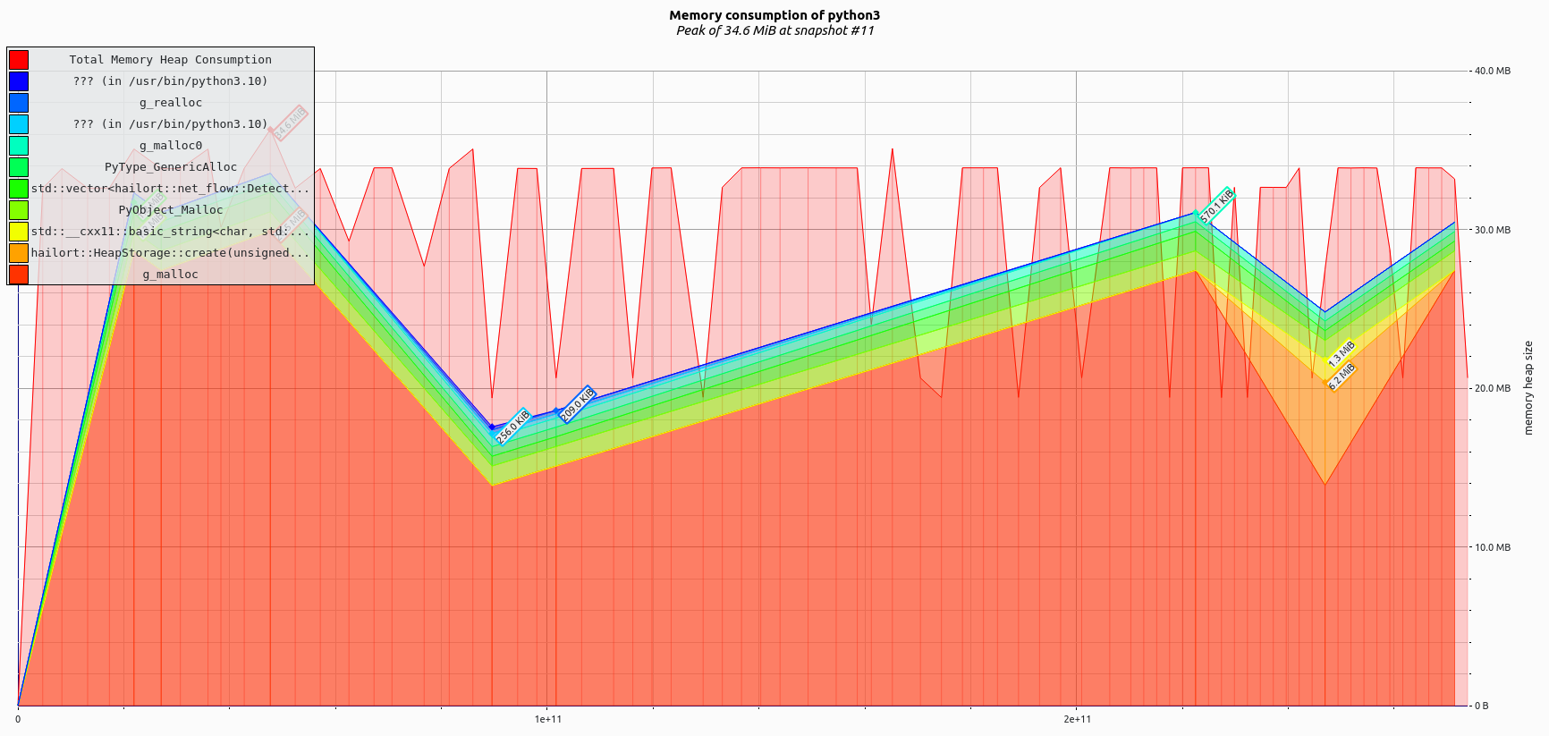

I run the script with multiple GStreamer pipelines in threads on V 4.20:
valgrind --tool=massif --massif-out-file=massif.out python3 script.py --input clip.mp4 --eos_after 10 --parallel 2 --n_restart 20
Then inspected the output:
massif-visualizer massif.out
Looks like there is no memory leak on V4.20. In case you still able to reproduce the issue, please let us know.
Hi @Michael,
thank you for taking the time to have a look at this issue. I updated my system to V 4.20 and at a first glance cant see any memory issue using valgrind.
This week I will be testing further just to be sure. I’ll get back to you when I have my results.
Hi @Michael,
I conducted some long term test and could not observe any memory issues. Thanks again for your time.
