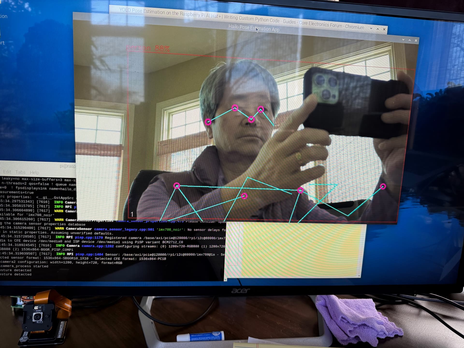

I saw this guide that appears closest code I can find in my extensive internet search and it is from following;
As a newbie, I realized what I’m trying to do requires way more than short learning curve & very limited resources available.
While I tried to figure out & modify this code (in wtype example that uses body key-point), I realized there is an issue in this code, this code supposed to trigger type letter K when both elbow are raised higher than nose but actually triggered by either one of elbow are higher than nose although if statement in the code clearly shows both elbow need to be higher to trigger type letter K
In the process, I modified code so it can send telegram & also made if statement to loop 5 times to minimize false detection and got so excited until I realized those were false detection.
And I’m still working on if statements to make this as fall detector but I’m stuck here @ no progress, since actual body key-point is not represented by if statement and triggers false detection
Can you please advise,
My setup (Pi5 Bookworm 8Gb fresh install with Hailo & picam3 noir

I think I found what is causing of this false detection.
Today, I tested this same code in standing up position that camera can see hip & whole upper body and then it worked; that condition on if statement met & triggered correct detection (that is only when both wrist are higher than nose) but this same code was not working when camera can not see hip & below, in sitting position with leg under table.
Looking at video feed while I was sitting on chair in front of camera that my hip & below were covered by desk and positioned under, I noticed pose detection on this model is actually projecting or estimating hip & below position in strange way that human body can not normally duplicate (see picture attached) and this perhaps caused false detection?
If so, what can I do to solve this issue?
Pose Detection will more likely produce false detection if people lying on bed or sitting on chair while covered by blanket over lower body, although detection calls for upper body pose detection using if statement based on x,y position coordinate of body key-point just like in this code case.
This code is very much possible to use for elderly people fall detection or pre warning only if there is work around preventing false detection while lower body is covered by blanket or sort
Help will be appreciated!
