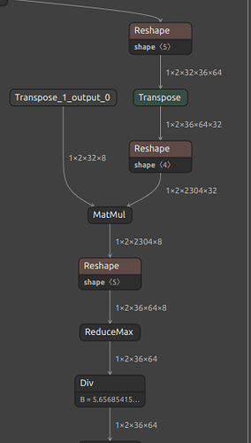

Looking closely at this error:
UnsupportedShuffleLayerError in op /model.12/attn/Reshape_2: Failed to determine type of layer to create in node /model.12/attn/Reshape_2
UnsupportedReduceMaxLayerError in op /model.12/attn/ReduceMax: Failed to create reduce max layer at vertex /model.12/attn/ReduceMax. Reduce max is only supported on the features axis, and with keepdim=True
UnsupportedShuffleLayerError in op /model.12/attn/Reshape_3: Failed to determine type of layer to create in node /model.12/attn/Reshape_3

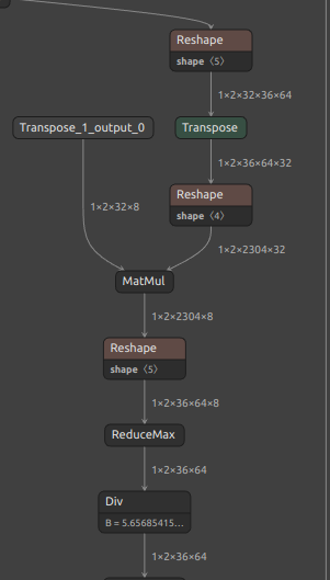

You can see that the same structure appears, with only the model part changed.
Below is one example image.
The commonality among the layers where UnsupportedShuffleLayerError occurs is that the dimensions change.
For Reshape_2, it changes from (1×2×36×64×32) to (1×2×2304×32),
For Reshape_3, it changes from (1×2×2304×8) to (1×2×36×64×8),
For ReduceMax, it changes from (1×2×36×64×8) to (1×2×36×64).
All of these are layers that transform between 4D and 5D.
Therefore, I thought these changes were the issue.
